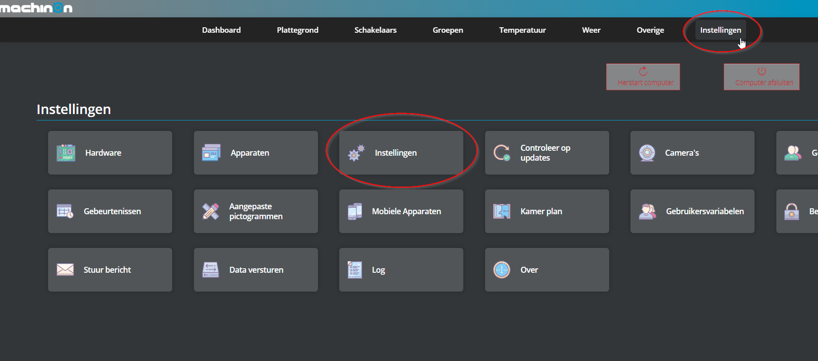

i dont see the theme edit menu in my domoticz tabs

i only find the following tabs in the settings:
System
Log History
Notifications
Email
Meters/Counters
Floorplan
Other
Backup/Restore
madpatrick
Posts: 758
Domoticz version: 2025.2
Re: machinon theme
Post by madpatrick »
Do you see the same in your view as this ?
2022-06-23 09_46_54-Domoticz - Instellingen.png (114.13 KiB) Viewed 4906 times
