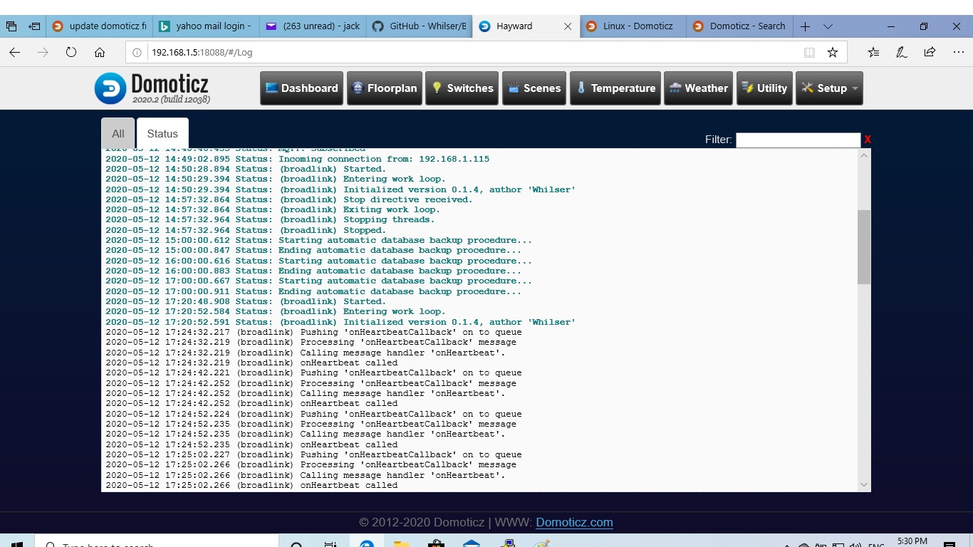

I ran into a problem installing Broadlink plugins it seems could not load python as displayed below. My python3 -V is 3.6.9 python -V is 2.7.17. I do not have the files python36.zip or lib-dynload as indicated in the error message. How can I get those? I have reinstalled python3.6, 3.7 to no avail.
-05-07 00:22:13.494 PROXY: Authenticate result: Error resolving host 192.168.1.5:18088: resolve: Host not found (authoritative). See https://en.wikipedia.org/wiki/Subnetwork.
2020-05-07 00:23:13.653 Error: PROXY: timeout occurred, reconnecting
2020-05-07 00:36:04.766 Error: (BroadlinkRM2) failed to load 'plugin.py', Python Path used was '/home/wanj/domoticz1/plugins/BroadlinkRM2/:/usr/lib/python36.zip:/usr/lib/python3.6:/usr/lib/python3.6:/usr/lib/python3.6/lib-dynload'.
2020-05-07 00:36:04.766 Error: (broadlink1) Module Import failed, exception: 'ModuleNotFoundError'
2020-05-07 00:36:04.766 Error: (broadlink1) Module Import failed: ' Name: broadlink'
2020-05-07 00:37:30.103 Error: broadlink1 hardware (7) thread seems to have ended unexpectedly
2020-05-07 00:38:00.111 Error: broadlink1 hardware (7) thread seems to have ended unexpectedly
2020-05-07 00:38:30.119 Error: broadlink1 hardware (7) thread seems to have ended unexpectedly
2020

Correction to the above, the directory lib-dynload is in the python3.6 directory, but the zip file referred in the error message is not.
Based on the answers few posts back
I've since edited the plugin_http.sh file in broadlinkRM2 subdirectory to reference python3 instead of python to match the version installed and referred to in the error message.
Also I've chmod -R 777 the broadlinkRM2 subdirectory to make sure it is read and write.
All the above changes did not have any affect to the error message, after I restarted the domoticz. These errors have only been affected the broadlink operation, other functions of Domoticz are function regularly.
