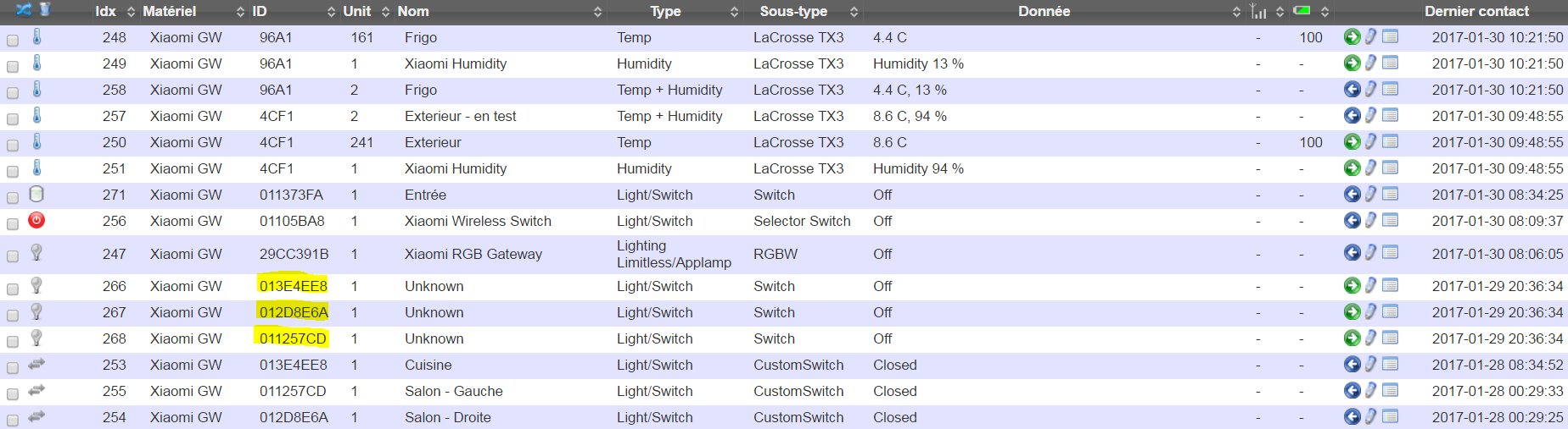

Post by lamouette »
Since few days, let's say, this weekend, 3 more devices appeared on my interface (running v3.6561 at the moment) :
3 light switches which I don't have :?: Any idea :idea: :?:
Other thing, my Wireless switch is only working with the "click" action. "double click" is not working any more.

lamouette wrote:Hi,
can you delete all the wireless switches, and see what gets added back in?

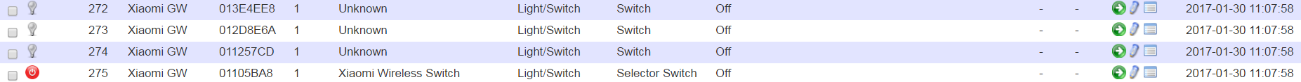

corbin
Posts: 463
Location: Brisbane, Australia
Post by corbin »
restarting the Xiaomi Gateway under hardware in Domoticz should make it scan for the switches straight away
lamouette
Posts: 37
Joined: Friday 20 January 2017 8:47
Location: France
Post by lamouette »
They are back :ugeek:

lamouette wrote:They are back :ugeek:
I had the same, actually it are no new switches, in the example you mentioned it was the cuisine switch.
I removed the old and rename the new to the old.
