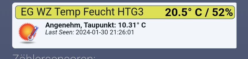

- imautohuttraeger
- Posts: 427
- Joined: Saturday 14 March 2020 13:40
- Domoticz version: latest
- Location: Germany
Re: ShellyTeacher for Domoticz
Many thanks for this detailed helping text! Will try tomorrow. But according to the online state: I always press the button for the H&T before I let the teacher scan it (I am leaving the back cover detached for this, as a little hole for a Paperclip is missing unfortunately

- imautohuttraeger
- Posts: 427
- Location: Germany
BINGO! After publishing the autodiscovery topic you have notified above via MQTT Explorer (checked raw format - default json did not work), the teacher finally detected the device.
Thank you very much once again - you are my hero!

- imautohuttraeger
- Posts: 427
- Location: Germany
Yes. A combined Device showing both temperature an humidity appears. Compare Screenshot.
Stop, look and listen.
