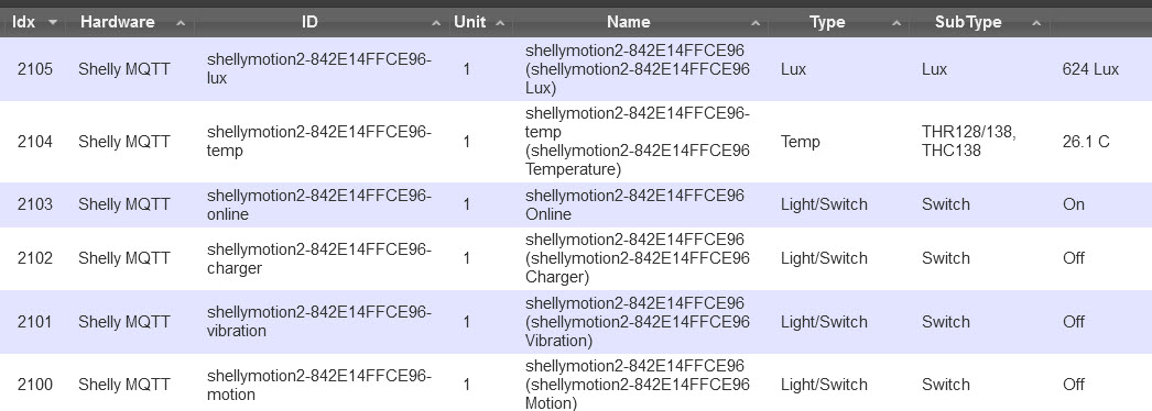

I just ran into the next problem :cry:
I have included a "Shelly Motion 2" with teacher.
The following devices were created:
The problem is, that only Lux and Temp are updated when a motion or tamper is triggered.
2024-01-21 13:09:51.334  Shelly MQTT: Temp/THR128/138, THC138 (shellymotion2-842E14FFCE96-temp (shellymotion2-842E14FFCE96 Temperature))
2024-01-21 13:09:51.447  Shelly MQTT: Lux/Lux (shellymotion2-842E14FFCE96 (shellymotion2-842E14FFCE96 Lux))
Any help is appreciated
