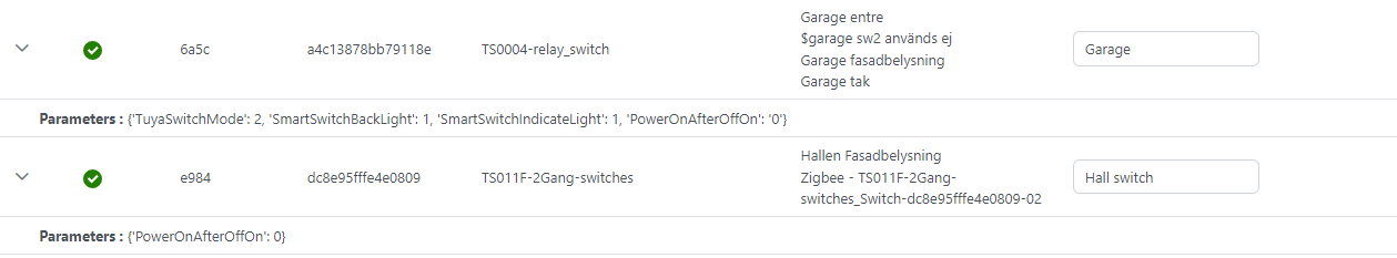

Just the other day I added 2 MOES Switch 2-gang modules. Both of them behave weird. They switch on and off seemingly random. The log in Domoticz doesn't give me any clue since it just says on and off - not who or what initiated it. These are new switches in Domoticz and they are not included in any scripts or Blockly events. I'm wondering if it might be something in the plugin causing this - or perhaps both modules are faulty?
Just a thought. When I compare the MOES switches with the Girier switch they have different Parameters. Could this be in indication that something could be off in the plugin?
girier and moes switch.PNG (17.05 KiB) Viewed 375 times
