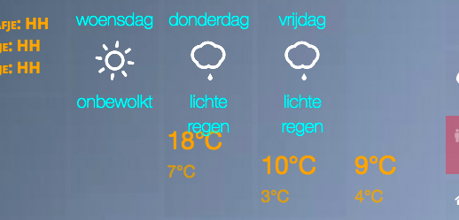

At the moment, it looks like this for me, any way to fix it (easily)
Schermafbeelding 2019-02-27 om 12.33.56.png (63.01 KiB) Viewed 2986 times

Can you please have a look at the varying column height per day/time slot? As shown above in my screenshot a few posts back, it can have big impact on screen layout. It would be nice when the columns would always be of equal height and the same height. Therefore my suggestion to reserve a 2nd line for the weather forecast text.
Lokonli
Posts: 2292
Re: Import weather data other than Wunderground
Post by Lokonli »
jake wrote: Tuesday 05 March 2019 16:58
@Lokonli
I'll have a look.
As a partial fix, add the following to custom.css for a fixed height of the complete block:
.weatherfull > .transbg {
  height: 250px !important;
Lokonli
Posts: 2292
Post by Lokonli »
Lokonli wrote: Tuesday 05 March 2019 17:46
@Lokonli
I'll have a look.
or prevent the line wrapping with:
  height: 170px !important;
  white-space: nowrap !important;

Post by Backlash »
nobody who can point us at the right direction?
HansieNL
Posts: 969
Post by HansieNL »
Just tried my config with Dashticz 3.5 master and the 'weather_owm' block has no problem.
What settings do you use (without API key)?
