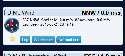

is there someone that have a windchill sensor or data can make a windchill?
- waaren
- Posts: 6028
Re: Import weather data other than Wunderground
Windchill is just the result of a formula with temperature and windspeed as factors.Derik wrote:is there someone that have a windchill sensor or data can make a windchill?

I now...waaren wrote: Tuesday 14 August 2018 10:03Windchill is just the result of a formula with temperature and windspeed as factors.Derik wrote:is there someone that have a windchill sensor or data can make a windchill?
Verstuurd vanaf mijn ONEPLUS A3003 met Tapatalk
Only what i look is a device that give me the chill in a sensor..
I have multiple weather data sensors
Only no separate windchill device..
Looks great on my dashboard.
windchill -10: kids need warmer clothing's
- waaren
- Posts: 6028
I can build a dzVents script if you give me the names of your outside temperature device and the name of your windspeed device.Derik wrote: Tuesday 21 August 2018 8:32I now...waaren wrote: Tuesday 14 August 2018 10:03Windchill is just the result of a formula with temperature and windspeed as factors.Derik wrote:is there someone that have a windchill sensor or data can make a windchill?

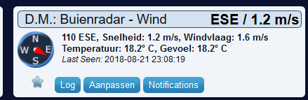

When you install the buienradar plugin you get a windchill perhaps you can split this data also? Temp: Wind:

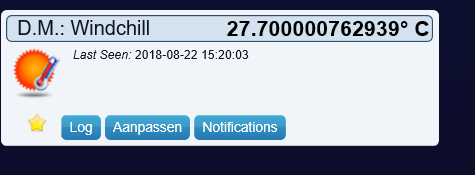

Zou ergens iets met afronden kunnen zijn?? And how do you calculate this chill?Is this a formula that is normal used by more weather stations??
Works:

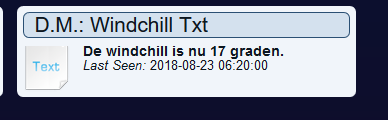

And is it perhaps possible that u send the calculate value to a text device
Something like:
The windchill is now -25 degrees [ where -25 the value is @ that moment ] [ Or in NL: De winchill is nu -25 graden ]

Yes. See new code below
Using the JAG/TI-method https://nl.wikipedia.org/wiki/GevoelstemperatuurAnd how do you calculate this chill?Is this a formula that is normal used by more weather stations??
Yes. See new code belowAnd is it perhaps possible that u send the calculate value to a text device
Something like:

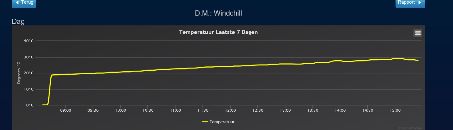

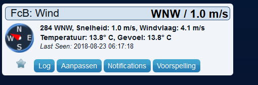

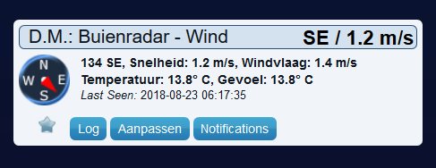

Dear Waaren..
Realy nice to see how you fix this..
The text is running also...
Only one thing
Probably your formula is wrong??
The chill is the same like outside temp..
And my other sensors give a different chill then your code: Yours: So perhaps you can check?
edit:
The script is not running for more the a half hour.,,,
So where do i go wrong?
Only one thing
edit:
- waaren
- Posts: 6028
Hi Derik,Derik wrote: Thursday 23 August 2018 6:25 Probably your formula is wrong??
In the edited script below, I switched on debug logging so if you can check again and look at the relevant loglines (the ones with the text "setWindchill" in it)
I doublechecked the formula and it should report the windchill temp calculated using the JAG/TI-method JAG/TI-method
Please note that according to this JAG/TI calculation the windchill temperature is equal to the standard temperature for temperatures > 17 Celsius and for windspeeds < 1.3 meter/second.
Also the script does not update the textdevice if the windChill temperature has not changed in the last 10 minutes.

myWind = dz.devices("D.M.: Buienradar - Wind") -- Name of your windDevice within quotes or idx without quotes
myWindChillTemp = dz.devices("new Windchill") -- Name of your windchill temp Device within quotes or idx without quotes or remove line completely if no temp device
myWindChillText = dz.devices("windChillText") -- Name of your windchill text Device within quotes or idx without quotes or remove line completely if no text device
----- enter your settings above this line -------------------------------------------------------------------------------
local function windChill(windSpeed, temperature)
if temperature == nil then return -99 -- Should not happen
elseif windSpeed == nil then return -99 -- Should not happen
-- chill temperature cannot be calculated for these conditions
elseif windSpeed < 1.3 or windSpeed > 49 or temperature < -46 or temperature > 17 then
return temperature
return 13.12 + (0.6215 * temperature) - (13.96 * math.pow(windSpeed, 0.16)) + (0.4867 * temperature * math.pow(windSpeed, 0.16))
dz.log("windspeed: " .. myWind.speed .. ", temperature: " .. myTemperature.temperature,dz.LOG_DEBUG)
local calculatedWindChill = dz.utils.round(windChill(myWind.speed,myTemperature.temperature))
if myWindChillTemp then
myWindChillTemp.updateTemperature(calculatedWindChill)
if myWindChillText then
local windChillText = "De windchill is nu " .. calculatedWindChill .. " graden."
if myWindChillText.text ~= windChillText then
myWindChillText.updateText(windChillText)
}Debian buster, bullseye on RPI-4, Intel NUC.
