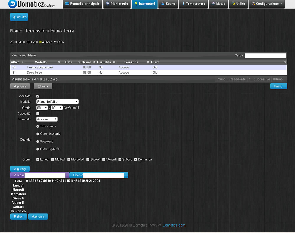

I made the changes but in the end I get a slightly strange page
Patricen
Posts: 119
Joined: Tuesday 06 February 2018 18:48
Domoticz version: Beta rel
Re: Weekly programming
Post by Patricen »
Looks like your cache hasn't been cleared.

Maybe I've ripped .... It was a problem that I had not updated the CSS files
Now, however, the temperature settings are still missing and still seems not to go .... After I check
For the Browser Cache problem, sometimes you can ovate by opening a New Window in disguise .......
