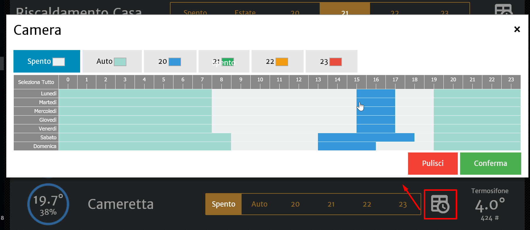

as promised, this is the final result.
as told I have to solve some issue, but as first result is very good (for me, sure :) )

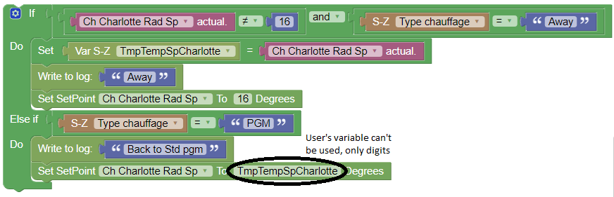

I'm currently struggling with a blockly "script" to try proceeding to this, but it looks like the script is only triggered when the virtual selector switch state changes. I then check actual T°(compared to the Eco value I set to 16° for example) + selector position as if planning schedule temperature changes while selector is in Eco mode, temperature setpoint will follow planning schedule and not selector switch position.
The issue is as follows : If selector goes back to "Normal" instead of "Eco", is there a way to grab out schedule temperature to go out of "Eco" setpoint?
Patricen
Posts: 119
Joined: Tuesday 06 February 2018 18:48
Domoticz version: Beta rel
Re: Weekly programming
Post by Patricen »
Update :
I found out some tricks :
In order to freeze "Away" mode, I check if setpoint temp is different from Away setpoint (16°C for this case) and if Away is selected. If setpoint temperature has changed, this means schedule is running and comfort/eco has been triggered.
Then, as the setpoint changes according to the schedule, it is stored in a user's variable to be able restoring it when switch is changed from "Away" to "PGM".
If "Away" goes back to "PGM", I'd like to restore the value as the current setpoint
The issue is that it is not possible to set a temperature as a variable, only digits can be used.
Any clue?

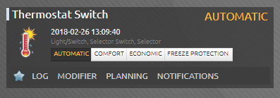

Hi Patrice
As I'm not sure to understand what you're trying to achieve with your blocky script,so I've done this with a lua script; you can either choose Automatic to follow the planning or Comfort,Eco,Freeze protection to force the predefined temperature and disable all setpointtimer to avoid a new plannig setpoint trigger.
thermostat switch.PNG (31.75 KiB) Viewed 3956 times
-- Definitions
local DOMOTICZ_IP = '127.0.0.1:8080'
local DEVICE = "THE NAME OF YOUR VIRTUAL THERMOSTAT SWITCH" --In my sample, "Thermostat Switch"
local DEVICE_ID = YOUR_SETPOINT_DEVICE_ID
-- Main script
if devicechanged[DEVICE] then
    json = assert(loadfile '/home/pi/domoticz/scripts/lua/JSON.lua')()  -- For Linux
    --   json = (loadfile "D:\\Domoticz\\scripts\\lua\\json.lua")()  -- For Windows
    --load all setpointtimers for the DEVICE_ID
    local url = 'http://'..DOMOTICZ_IP..'/json.htm?type=setpointtimers&idx='..DEVICE_ID
    --print (url)
    local config=assert(io.popen('curl "' .. url .. '"'))
    local blocjson = config:read('*all')
    config:close()
    --print ('blocjson:' .. blocjson)
    local jsonResult = json:decode(blocjson).result
    local vrb= "disablesetpointtimer";
    local NewLevel = devicechanged[DEVICE];
    print ('New level command:' .. NewLevel)
    if NewLevel == "Automatic" then
        vrb = "enablesetpointtimer";
   	local temp = 6
        if NewLevel == "Comfort" then
            temp = 21
        elseif NewLevel == "Economic" then
            temp = 18
        --update the Setpoint to the predefined temperature
        commandArray['UpdateDevice'] = DEVICE_ID .. "|0|" .. temp
    --change all setpointtimers of DEVIDE_ID to the desired state : disabled of enabled
    for i,setpoint in ipairs(jsonResult) do
        os.execute ('curl "http://' .. (DOMOTICZ_IP) .. '/json.htm?type=command&param='..vrb..'&idx=' .. (setpoint.idx) ..'"');
return commandArray
Would it be good for you with this?
