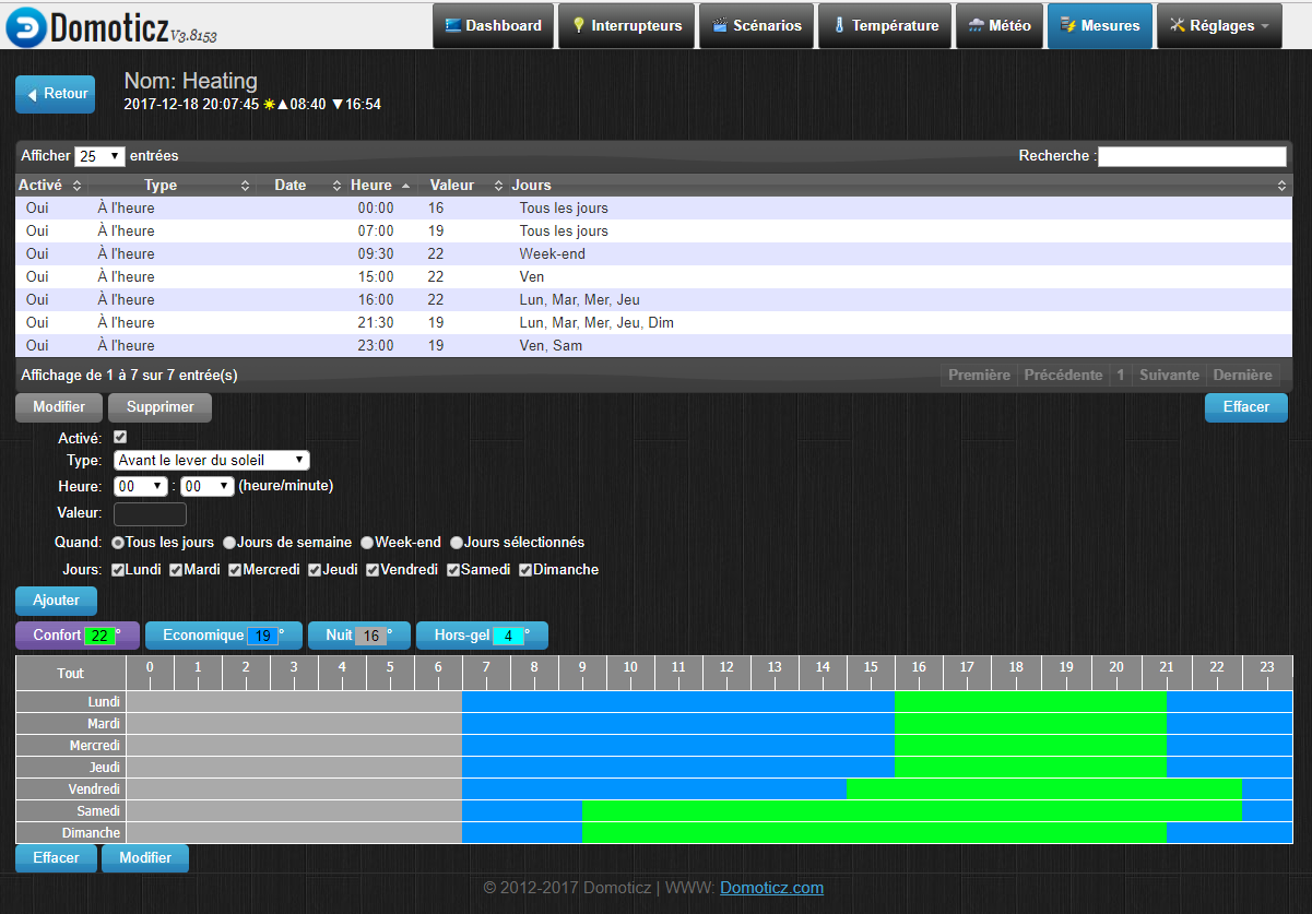

I'm a new Domoticz addict. I had previously a zipabox but too limited and have to pay to use user variable in command.
So, I'm concern about a thermostat program.
I've developped an "easy" way to see and create a weekly heating program up to 4 differents temperatures(adjustables).
I've changed the utility part to get this:
EDIT 12/12/2018 On latest version, you can:
select time range from 1 hour to 10 mins.
program on 2 weeks with odd & even weeks mode
decactivate the entire "program" and activate it later without any need to delete all timers
The graph table load setpoints and display its (if type = "On time" or "Odd & Even weeks")
To use it, click on one of 4 temperature button and click :
- on top left corner to select all
- on hour column to select one complete hour for all days
- on semi-hour column to select half hour column for all days
- on days to select an entire day
- on a cell to select a specific time at a specific day
You can edit temperature's values on buttons to select your own ones.
When user click on Update, all setpoints are cleared and replaced by new ones.
If it is interesting the team, I would be happy to contribute and add this on gitbub.

For people interesting, joined required files.
I have changed :
app/utilityControler.js
views/utility.html
css/style.css
Do a backup of your existing files before replacing by joined files.
To update files on your web browser, change in thefile html5.appcache the ref number to force to reload aplication files.
CACHE MANIFEST
# ref INCREASE_NUMBER_HERE
Hope this would help you to create your planning

Ok, implemented!
I think your work it's fantastic!
But.. I want to try to do a change for my use, because I want to use it also for "switch selector".
you think that it's possible? I have this switch selector:

syrhus
- Posts: 79
- Joined: Tuesday 12 December 2017 14:10
- Domoticz version: 2021.1
- Location: Paris
Re: Weekly heating programming
Hi bigpea
Thank you.
That's a very interesting way to use your selector switch! I've seen there is not yet mutualisation of js code between switches and utilities.
So, for now, to do what you want to achieve, you have to change :
app/lightscontroller.js
views/lights.html
and the planning javascript code to play whith your switch levels instead of the 4 temperatures values
As your request is very intersting to do this with switch levels, I will look at how to implement it on both sides (lights and utilities).

Santa is coming!
So,with this version, the user can plan for a week:
- thermostat temperature (setpoint)
- light On/Off
- light selector
Do a backup of or files before replacing with joined ones.
In the html5.appcache file , change the ref value to force to refresh files on your web browser
Have a nice christmas day before the d day
