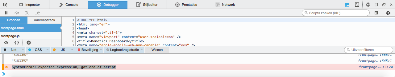

Post by Skorpion »
G3rard wrote:
Skorpion wrote: I use Hue color, LivingColors and LivingWhites. I double checked the code, and as far as I can see, it doesn't differ from yours. There probably must be a faulty piece of code in my files though, because my RPi cpu usage goes sky high when I enable the dimmer function for one or multiple lamps.
Does it work if you use the frontpage.js file from the version I have shared in this topic?
So far, no succes here. But I will keep trying to get it to work.
Edit:
I found out that, while testing in my Firefox webconsole, I get this error "SyntaxError: expected expression, got end of script" , when I press the minus or plus button to dim the lights. It directs me to the frontpage.html line 1 rule. Nothing exciting there, so does anyone know where or how this problem can be fixed?
Thanks in advance!
