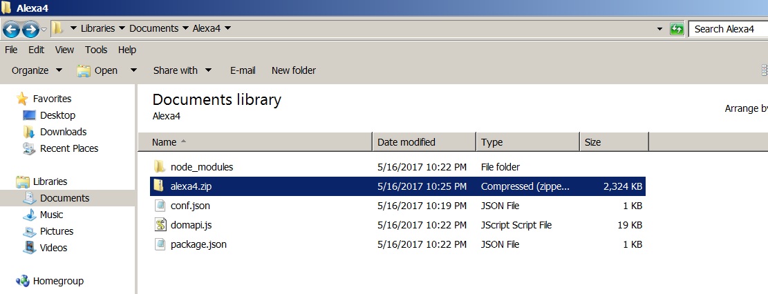

I'm trying to update to the latest version but keep getting this error:
  "errorMessage": "Cannot find module 'hsl-to-rgb-for-reals'",
  "errorType": "Error",
  "stackTrace": [
    "Module.require (module.js:353:17)",
    "require (internal/module.js:12:17)",
    "Object.<anonymous> (/var/task/node_modules/hsl-to-hex/index.js:3:13)",
    "Module._compile (module.js:409:26)",
    "Object.Module._extensions..js (module.js:416:10)",
    "Module.load (module.js:343:32)",
    "Function.Module._load (module.js:300:12)",
What am I doing wrong?
Madgeni
Posts: 1571
Re: Amazon Echo to Domoticz Bridge: switches, sensors & more
Post by Madgeni »
Hi markk - you'll need to pull the node_modules folder also - i've included a couple of libraries to convert hue to hex
markk
Posts: 267
Post by markk »
hi Madgeni
I downloaded the whole zip from github into a separate folder, changed the config.json and then zipped all 4 new files, including the node_modules folder together !
Madgeni
Posts: 1571
Post by Madgeni »
weird - and that module is in the node_modules folder?
markk
Posts: 267
Post by markk »
yep
here's the folder. The zip contains the three downloaded today plus the amended conf.json :?
Madgeni
Posts: 1571
Post by Madgeni »
i've just tested it again on the lambda, and all seems well this end?

markk
Posts: 267
Post by markk »
How odd.
just tried again with your test but still no good. Here's the cloud watch report:
START RequestId: 9641d249-3ae4-11e7-8db5-ab8d427fed42 Version: $LATEST
Unable to import module 'domapi': Error
at Function.Module._resolveFilename (module.js:325:15)
at Function.Module._load (module.js:276:25)
at Module.require (module.js:353:17)
at require (internal/module.js:12:17)
at Object.<anonymous> (/var/task/node_modules/hsl-to-hex/index.js:3:13)
at Module._compile (module.js:409:26)
at Object.Module._extensions..js (module.js:416:10)
at Module.load (module.js:343:32)
at Function.Module._load (module.js:300:12)
END RequestId: 9641d249-3ae4-11e7-8db5-ab8d427fed42
REPORT RequestId: 9641d249-3ae4-11e7-8db5-ab8d427fed42	Duration: 9.78 ms	Billed Duration: 100 ms Memory Size: 512 MB	Max Memory Used: 36 MB
Madgeni
Posts: 1571
Post by Madgeni »
i must have broken something - i'll go through it again
Madgeni
Posts: 1571
Post by Madgeni »
I've added a zipped file which has my current files (the same as on github) to github - this is the one i'm using - try that?
