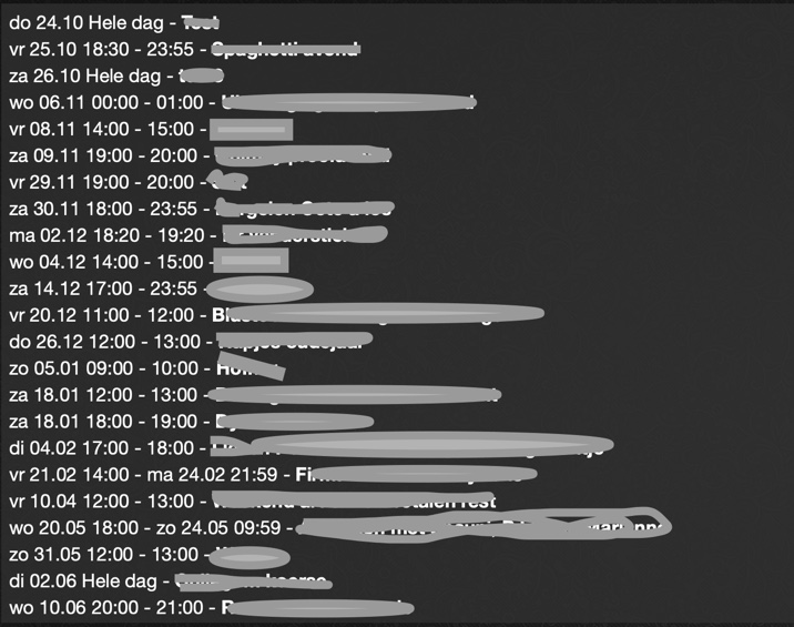

Post by Stepdes »
Lokonli wrote: Wednesday 23 October 2019 21:21
Could you test the calendar layout changes in the latest beta? Preferably for calFormat:0 as well as calFormat:1
Thnx for the update!
As you can see, first image calFomat 0, second calFormat 1.
The allday events now show without start hour
Foto 24-10-19 om 07.48.jpg (132.44 KiB) Viewed 5620 times
Foto 24-10-19 om 07.51.jpg (65.63 KiB) Viewed 5620 times
Lokonli
Posts: 2292
Re: Dashticz - Bug report
Post by Lokonli »
Perfect. Thanks for testing.

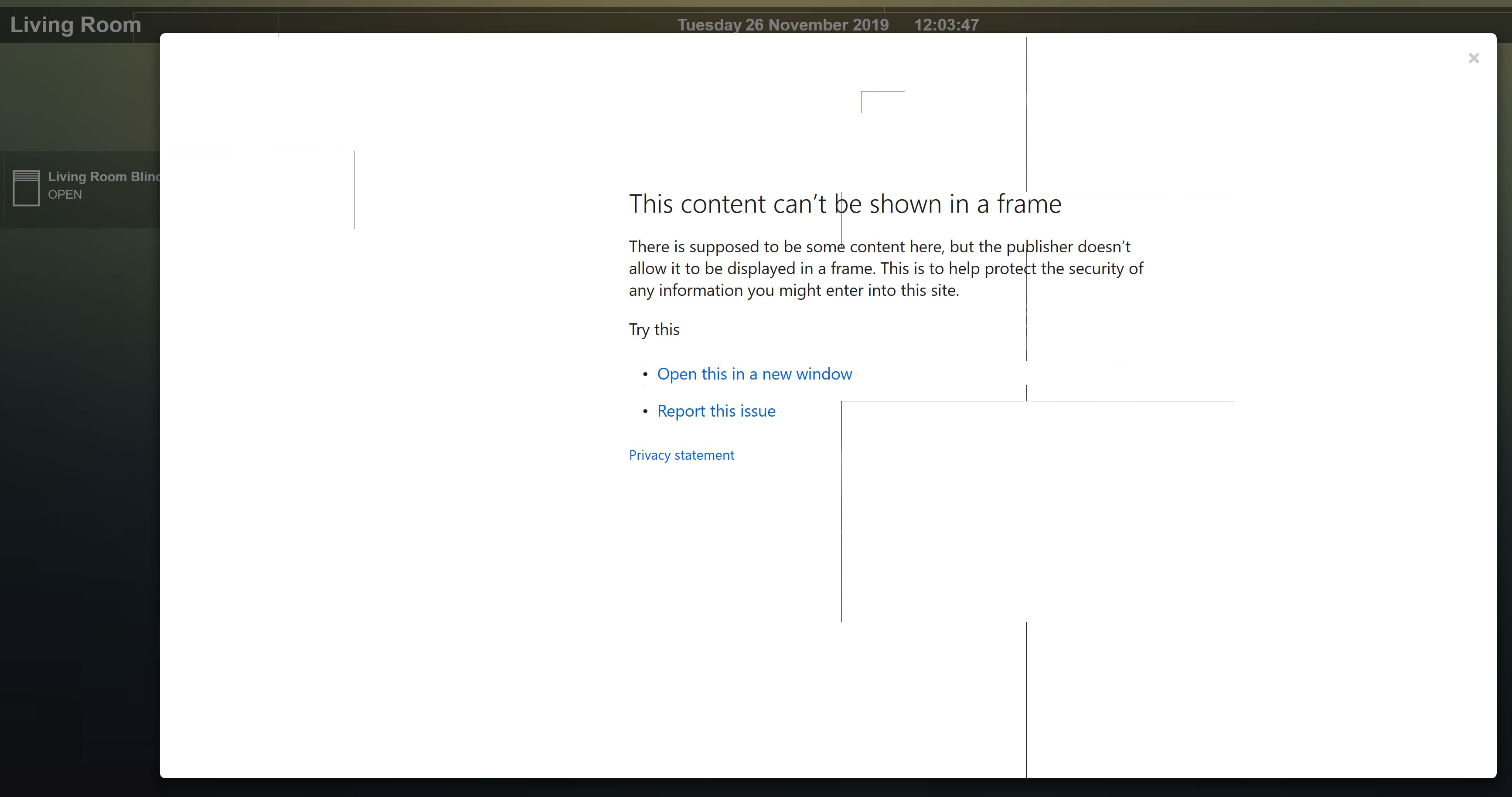

I'm trying to display an image snapshot from my Foscam from the url:
http://192.168.0.61/cgi-bin/CGIProxy.fcgi?cmd=snapPicture2&usr=admin&pwd=password
CONFIG.js
var buttons = {}
buttons.webcam = {
  image:"//192.168.0.61/cgi-bin/CGIProxy.fcgi?cmd=snapPicture2&usr=admin&pwd=password",
  url:"//192.168.0.61/cgi-bin/CGIProxy.fcgi?cmd=snapPicture2&usr=admin&pwd=password",
  isimage:true,
  width: 12,
  refresh: 2000
It displays the image fine but when I click on it I get this error message in Chrome:
"This content can't be shown in a frame"
HansieNL

@ben53252642 : Some pages will not load in a frame because the publisher of the webpage doesn't allow that. The only thing you can try is to load that page in an own webpage and link to that page.
Blah blah blah
Lokonli
Posts: 2292
Post by Lokonli »
HansieNL wrote: Tuesday 26 November 2019 13:12 @ben53252642 : Some pages will not load in a frame because the publisher of the webpage doesn't allow that. The only thing you can try is to load that page in an own webpage and link to that page.
In this case the url points to an image, not an html page, I guess.
What we could do is open the image directly, not within an iframe. We could show it as a popup window.
Would that be useful?

I've managed to work around the issue using a combination of a php cors proxy hosted on my local Apache server and a dedicated html page.
