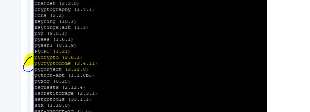

@kniazio
you will be on trouble if you need these ones:
Broadlink plugin will not work in this case.

As Zak said, also remove pycrypto (if you do not need it). I did not remove pycrptodome at the time... and I am able to connect to the Broadlink

pycryptodome
On my side, as I said, I have still pycryptodome. Try to remove pycrypto only at first

Darkneo wrote: Friday 08 March 2019 16:14 Typo issue on my side.
pycryptodome
hands are falling
Re: Python Plugin : Broadlink RM2 V4
Posted: Friday 08 March 2019 16:25
by kniazio
pycrypto removed
it still does not work
