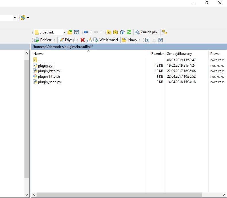

kniazio
- Posts: 204
- Joined: Thursday 06 October 2016 8:14
- Domoticz version: 3.7243
Re: Python Plugin : Broadlink RM2 V4
Broadlink not running
- domot.jpg (82.61 KiB) Viewed 3056 times

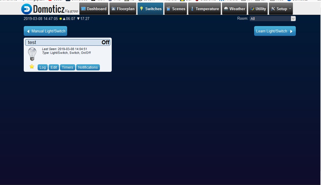

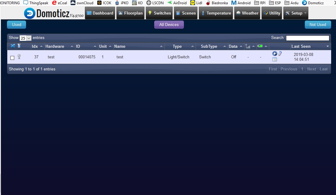

Darkneo
- Posts: 24
- Joined: Sunday 10 February 2019 16:22
Anyway, your broadlink folder is not correct (or not the one I used). In domoticz/plugins you shall have "BroadlinkRM2", copying the .py files within it, ns copy the broadlin folder (that shall contain ___init___.py file). Rename your broadlink folder to BroadlinkRM2 and copy the broadlink folder (for me, it was in /root/python-broadlink/broadlink) to the BroadlinkRM2 folder (a chmod +X on the __init___.py might be needed... I don't remember... try without the chmod and see what it gives
I think you're in the Device manager. After adding the hardware Broadlink, new switches are directly created. As you have no errors on your logs, I think t'oure on good track.

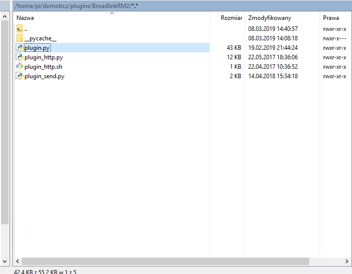

kniazio
- Posts: 204
Darkneo wrote: Friday 08 March 2019 14:40 Hi,
I think you're in the Device manager. After adding the hardware Broadlink, new switches are directly created. As you have no errors on your logs, please check that you have the Broadlink switch created correctly
EDIT: BTW, your broadlink folder is not correct (or not the one I used). In Plugin you shall have "BroadlinkRM2", copying the .py files within it, ns copy the broadlin folder (that shall contain ___init___.py file)
- brdl.jpg (45.36 KiB) Viewed 3049 times
- switches.jpg (62.98 KiB) Viewed 3052 times
Darkneo
- Posts: 24
Sorry I edited the previous post while comparing your installation folders to mine.
Editing all together
No you need to copy the Broadlink folder itslef (find -iname broadlink) with all the content. normally it shall ony content a file __init__.py and eventually a pycache folder)
And I guess you will have to restart your domoticz after doing so... OR at leat to "recreate" the hardware. I would recommand restart Domoticz

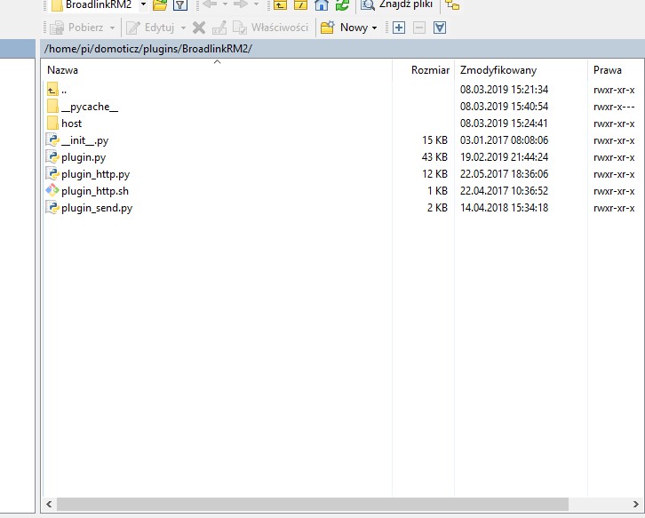

Darkneo
- Posts: 24
__init__.py shall be in another folder.
~/BroadlinkRM2:
plugin.py
plugin_http.py
plugin_http.sh
plugin_send.py
~/BroadlinkRM2/broadlink:
__init__.py
As Zak said, also remove pycrypto (if you do not need it). I did not remove pycrptodome at the time... and I am able to connect to the Broadlink
~/BroadlinkRM2:
plugin.py
plugin_http.py
plugin_http.sh
plugin_send.py
__init__.py

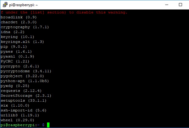

kniazio
- Posts: 204
I do not have
- crypto.jpg (70.11 KiB) Viewed 3030 times

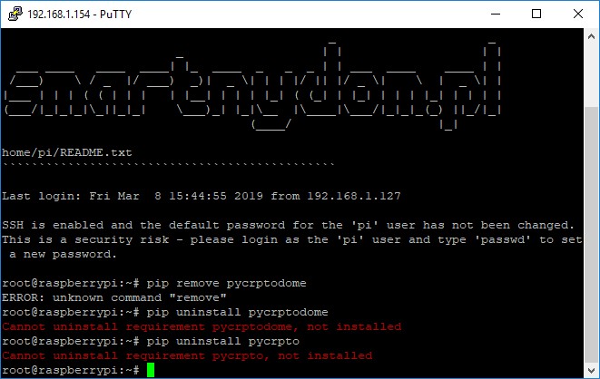

Darkneo
- Posts: 24
Typo issue on my side.
pycryptodome
On my side, as I said, I have still pycryptodome. Try to remove pycrypto only at first
pycryptodome
kniazio
- Posts: 204
hands are fallingDarkneo wrote: Friday 08 March 2019 16:14 Typo issue on my side.
pycryptodome
- pycrypto.jpg (73.87 KiB) Viewed 3028 times
kniazio
- Posts: 204
pycrypto removed
it still does not work
Can you specify the location of the files with the plugin?
Maybe I have bad files
Send me your files
Send me your files
Darkneo
- Posts: 24
Regarding your module list, we have the same files. But I cant send you a zip file later tonight.
in SSH could you please go to plugin folder:
Then:
Then:
Then:
cd /home/pi/domoticz/plugins
ls -aCode: Select all
cd BroadlinkRM2Code: Select all
ls -a-
