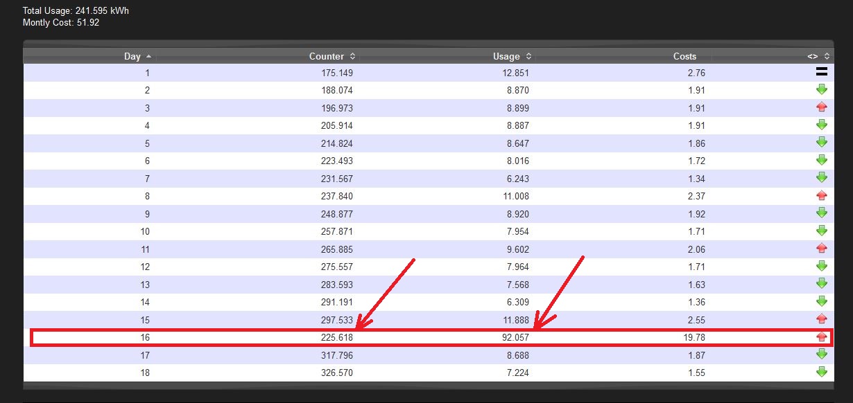

screen shot
screen shot
I have problems with the count of the current used ( kWh Meter ), counter/usage detected an anomalous data ( only one day ) , as shown in the image .
Could you tell why ? It's possible correct the data manually ?
