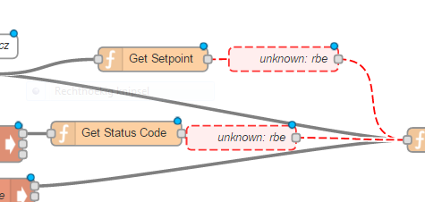

All flows import fine in the node-red on my pi except you latest. After the functions 2 unknown nodes "unknown rbe" have appearedpepijn wrote:Here is my current Node-RED flow, have fun.
[{"id":"22a46350.4b5c8c","type":"mqtt-broker","broker":"127.0.0.1","port":"1883","clientid":"","usetls":false,"verifyservercert":true,"compatmode":true,"keepalive":15,"cleansession":true,"willQos":"0","birthQos":"0"},{"id":"8b0bfef4.74f4","type":"inject","z":"b83a61b3.47c5a","name":"","topic":"nefit-update","payload":"","payloadType":"date","repeat":"30","crontab":"","once":true,"x":210.92857360839844,"y":72.4285717010498,"wires":[["b358d0b9.4ca73"]]},{"id":"b358d0b9.4ca73","type":"exec","z":"b83a61b3.47c5a","command":"/opt/nefit/nefit-status","addpay":false,"append":"","useSpawn":"","name":"Nefit Status","x":366.3730163574219,"y":72.09524345397949,"wires":[["6ebefa6b.914104","5ddfad82.a22054"],[],[]]},{"id":"3876c9bf.c78936","type":"debug","z":"b83a61b3.47c5a","name":"","active":true,"console":"true","complete":"true","x":1248.1825561523438,"y":201.17855834960938,"wires":[]},{"id":"1caaaa11.e35556","type":"mqtt in","z":"b83a61b3.47c5a","name":"domoticz/out/#","topic":"domoticz/out/#","broker":"22a46350.4b5c8c","x":195.92855834960938,"y":371.4285717010498,"wires":[["577c156d.a883ec"]]},{"id":"577c156d.a883ec","type":"function","z":"b83a61b3.47c5a","name":"de-jsonify","func":"var payload = JSON.parse(msg.payload);\nreturn payload;","outputs":1,"noerr":0,"x":361.9285583496094,"y":371.4285717010498,"wires":[["342ad05e.cbd53"]]},{"id":"23467d6a.dcb982","type":"debug","z":"b83a61b3.47c5a","name":"","active":true,"console":"false","complete":"true","x":1073.1785583496094,"y":357.1785717010498,"wires":[]},{"id":"50e0c648.af1f38","type":"function","z":"b83a61b3.47c5a","name":"Get SetPoint Value","func":"msg.payload = msg.svalue1\nreturn msg;","outputs":1,"noerr":0,"x":741.1230239868164,"y":370.5118885040283,"wires":[["a97981c8.56868"]]},{"id":"342ad05e.cbd53","type":"switch","z":"b83a61b3.47c5a","name":"filter Setpoint IDX","property":"idx","rules":[{"t":"eq","v":"160"}],"checkall":"true","outputs":1,"x":540.3729858398438,"y":370.9841136932373,"wires":[["50e0c648.af1f38"]]},{"id":"a97981c8.56868","type":"exec","z":"b83a61b3.47c5a","command":"/opt/nefit/nefit-set","addpay":true,"append":"","useSpawn":"","name":"Nefit Set Temp","x":930.9285697937012,"y":370.17857551574707,"wires":[["23467d6a.dcb982"],[],[]]},{"id":"6440aca2.9bbf54","type":"comment","z":"b83a61b3.47c5a","name":"Read changes from Domoticz and send to Easy","info":"","x":296.9285583496094,"y":334.4285717010498,"wires":[]},{"id":"6ebefa6b.914104","type":"function","z":"b83a61b3.47c5a","name":"Domoticz MQTT","func":"// Configuration\nconst IDX_SetPoint = 160;\nconst IDX_RoomTemp = 161;\nconst IDX_Pressure = 162;\nconst IDX_StatusCode = 163;\n\n\nvar domoticz_msg = {};\ndomoticz_msg.topic = \"domoticz/in\";\ndomoticz_msg.payload = {};\n\nif (msg.topic == 'nefit-update') {\n var NefitJSON = JSON.parse(msg.payload);\n domoticz_msg.payload.idx = IDX_RoomTemp;\n domoticz_msg.payload.nvalue = 0;\n domoticz_msg.payload.svalue = \"\" + NefitJSON['in house temp'];\n}\nif (msg.topic == 'nefit-pressure') {\n var NefitJSON = JSON.parse(msg.payload);\n domoticz_msg.payload.idx = IDX_Pressure;\n domoticz_msg.payload.nvalue = 0;\n domoticz_msg.payload.svalue = \"\" + NefitJSON['pressure'];\n}\nif (msg.topic == 'nefit-setpoint') {\n domoticz_msg.payload.idx = IDX_SetPoint;\n domoticz_msg.payload.nvalue = 0;\n domoticz_msg.payload.svalue = \"\" + msg.payload;\n}\nif (msg.topic == 'nefit-statuscode') {\n domoticz_msg.payload.idx = IDX_StatusCode;\n domoticz_msg.payload.nvalue = 0;\n domoticz_msg.payload.svalue = \"\" + msg.payload;\n}\n\nreturn domoticz_msg;","outputs":1,"noerr":0,"x":1028.4285354614258,"y":140.78571891784668,"wires":[["5bc7035e.a438fc","3876c9bf.c78936"]]},{"id":"5bc7035e.a438fc","type":"mqtt out","z":"b83a61b3.47c5a","name":"Domoticz MQTT","topic":"","qos":"","retain":"","broker":"22a46350.4b5c8c","x":1273.1785507202148,"y":142.53571319580078,"wires":[]},{"id":"2f2db332.d0d24c","type":"exec","z":"b83a61b3.47c5a","command":"/opt/nefit/nefit-pressure","addpay":false,"append":"","useSpawn":"","name":"Nefit Easy Pressure","x":393.9285659790039,"y":211.17857551574707,"wires":[["6ebefa6b.914104"],[],[]]},{"id":"baf3b005.450c5","type":"inject","z":"b83a61b3.47c5a","name":"","topic":"nefit-pressure","payload":"","payloadType":"date","repeat":"300","crontab":"","once":false,"x":208.67857360839844,"y":211.17857551574707,"wires":[["2f2db332.d0d24c"]]},{"id":"2b4dca2.fd4b236","type":"comment","z":"b83a61b3.47c5a","name":"Publish data from Nefit Easy Client to Domoticz","info":"","x":289.9285583496094,"y":24.428571701049805,"wires":[]},{"id":"906bc261.6f944","type":"rbe","z":"b83a61b3.47c5a","name":"","func":"rbe","gap":"","x":794.1428527832031,"y":40.42856979370117,"wires":[["6ebefa6b.914104"]]},{"id":"5ddfad82.a22054","type":"function","z":"b83a61b3.47c5a","name":"Get Setpoint","func":"var NefitJSON = JSON.parse(msg.payload);\nmsg.topic = 'nefit-setpoint';\nmsg.payload = NefitJSON['temp setpoint'];\nreturn msg;","outputs":1,"noerr":0,"x":632,"y":40.571428298950195,"wires":[["906bc261.6f944"]]},{"id":"2296752e.dd698a","type":"inject","z":"b83a61b3.47c5a","name":"","topic":"nefit-statuscode","payload":"","payloadType":"date","repeat":"10","crontab":"","once":false,"x":200.57141876220703,"y":145.6785717010498,"wires":[["4e5066ef.b1af98"]]},{"id":"4e5066ef.b1af98","type":"exec","z":"b83a61b3.47c5a","command":"/opt/nefit/nefit-code","addpay":false,"append":"","useSpawn":"","name":"Nefit Status Code","x":386.1785659790039,"y":145.92857360839844,"wires":[["8e61f998.719e08"],[],[]]},{"id":"8e61f998.719e08","type":"function","z":"b83a61b3.47c5a","name":"Get Status Code","func":"var NefitJSON = JSON.parse(msg.payload);\nmsg.topic = 'nefit-statuscode';\nmsg.payload = \"\"+\"[ \"+NefitJSON['code']+\" ] \"+NefitJSON['description'];\nreturn msg;","outputs":1,"noerr":0,"x":586.4285888671875,"y":132.92857360839844,"wires":[["8553f832.7aac08"]]},{"id":"8553f832.7aac08","type":"rbe","z":"b83a61b3.47c5a","name":"","func":"rbe","gap":"","x":741.5714111328125,"y":138.14286041259766,"wires":[["6ebefa6b.914104"]]}]
Message:
"This node is a type unknown to your installation of Node-RED.
If you deploy with the node in this state, it's configuration will be preserved, but the flow will not start until the missing type is installed.
See the Info side bar for more help"
[img]Knipsel.PNG[/img]
Updating my version isnt working

Dutchsea wrote:All flows import fine in the node-red on my pi except you latest. After the functions 2 unknown nodes "unknown rbe" have appearedpepijn wrote:Here is my current Node-RED flow, have fun.
Message:
~ $ sudo apt-get install nodered Reading package lists... Done Building dependency tree Reading state information... Done E: Unable to locate package nodered
Same issue here

here too. Updated node.js and created scripts (pepijn). Dummy sensors created. But cannot update node-red unfortunately. The nefit client is working because I saw some values when using the 3 export functions.andreo wrote:Dutchsea wrote:All flows import fine in the node-red on my pi except you latest. After the functions 2 unknown nodes "unknown rbe" have appearedpepijn wrote:Here is my current Node-RED flow, have fun.
Message:
Same issue here
pepijn
- Posts: 251
- Joined: Friday 12 July 2013 13:19
Re: Nefit Easy™ client library (How to install on the Pi)
You cannot upgrade Node-RED with apt-get.
See http://nodered.org/docs/getting-started/upgrading.html
Holland
- Posts: 179
- Joined: Friday 12 July 2013 13:53
- Domoticz version: Beta Ch
Have you tried the following?
npm update-
dorenberg
- Posts: 111
- Joined: Monday 22 June 2015 20:18
- Domoticz version: 4.10982
- Location: Veghel, The Netherlands
Succeeded with the node-red update using:
Node-red gives no longer the rbe error of unknown node.
However, I am getting XMPP error when executing the scripts nefit-pressure. Copy/paste the script in putty gives good results.
sudo npm cache clean
sudo npm install -g --unsafe-perm node-redHowever, I am getting XMPP error when executing the scripts nefit-pressure. Copy/paste the script in putty gives good results.
