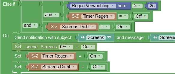

Yeah please ;) Also a Windows user. Have ordered screens but the fibaro module is already installed. So I have al the time preparing the windows script for it.
1x Intel NUC8i5BEK (Windows 10 x64) Domoticz on Virtualbox with DietPi.

I have taken the script of tlpeter and made it to my needs.
I have done the following
- Integrate the script with the rain prediction of 'buienradar'.
- made user variables from the thresholds in Domoticz so I can control it from the web interface.

Thanks for the script. I tested it (only on temperature).
Outside temp. is 25 degrees. When i set the treshold variable on 30 the screen is Up (off). When is switch manually down (on) it goes up. so thats ok. Because temperature is too low.
But when i set the treshold temperature on 12 degrees nothing happens.... Up or down, the status is ok.
Which blinds switch did you use?? Looks like up/down, open/close on/off are mixed?
Luuc_a
Posts: 24
Joined: Tuesday 16 July 2013 10:12
Re: Is it gonna rain within the next X minutes?
Post by Luuc_a »
Do you have a override switch called "Zonnescherm manual override"? The first time I used it I had the same sort of issues. Then I saw that I don't had the override switch.
When you don't want to use the override script you can edit the code:
 elseif (otherdevices['Zonnescherm'] == 'Closed' and sWeatherTemp < TempThreshold and otherdevices['Zonnescherm manual override'] == 'Off') then
to
elseif (otherdevices['Zonnescherm'] == 'Closed' and sWeatherTemp < TempThreshold) then
and the same for the UV check.

I would like to use the outcome of the rain value/virtual humidity sensor in blocky. But for some reason blocky doesn't seem to respond to the value of the virtual humidity sensor. anybody has an idea?
Brutus
Posts: 249
Joined: Friday 26 September 2014 9:33
Post by Brutus »
jjnj wrote:I would like to use the outcome of the rain value/virtual humidity sensor in blocky. But for some reason blocky doesn't seem to respond to the value of the virtual humidity sensor. anybody has an idea?
Can you post an example of your Blockly?

jjnj
Post by jjnj »
Just a plain and simple blocky just to test
Brutus
Posts: 249
Post by Brutus »
jjnj wrote:
I think you need to compare something like in my Blockly:
And I have my doubts about the "open" command.
Maybe test to write something in the log file or send a notification.
Timer Regen = virtual switch that is on when there is rain and off when there isn't. (needed for not creating loops in blockly).
