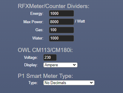

Well your post inspired me indeed.
As shown here max watt can be configured.
I ran into this 'issue' as one of my friend with 64 solar panels triggered the limit ;-).
After adjusting problem solved.
So indeed a configuration kind of 'correction' to prevent ridiculous values.
