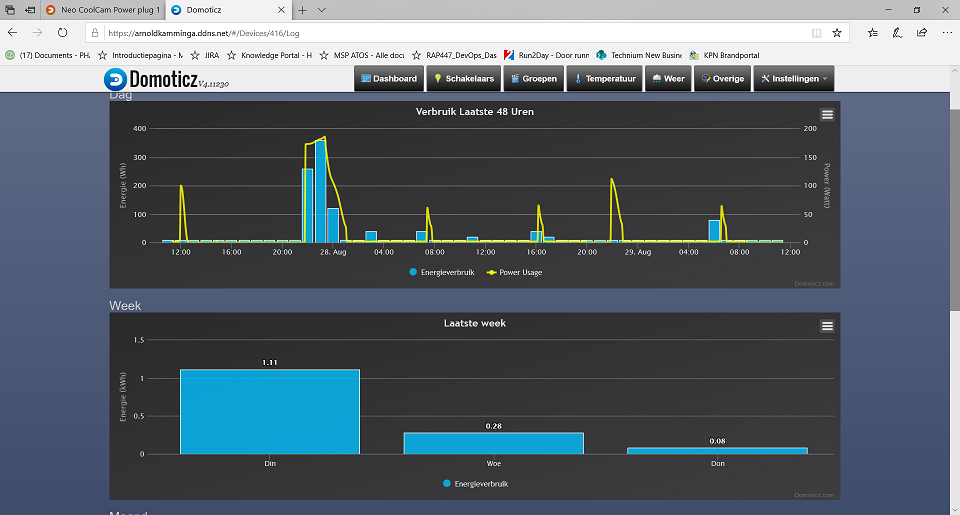

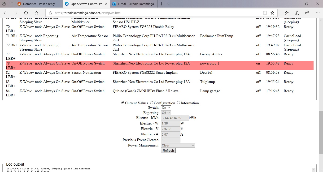

1. Apparently the kwh value in the device itself is not initialised correctly: There is a very big negative value reported by the device itself. (bug in the device)
afbeelding 2.jpg (239.46 KiB) Viewed 7079 times

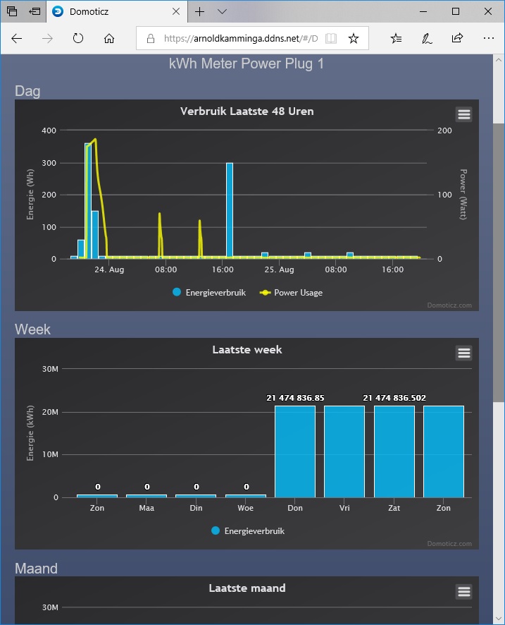

2. This should not bother domoticz, because it is an incremental counter. The value itself is not relevant, only the increment between 2 reported values. Domoticz does not seem to handle this negative value correctly: See graph below: for the 48 hr history the increments are calculated correctly. However for the last month graph (lower graph) when the increments are calculated on a daily basis they seem to be calculated incorrectly in case of these big negative absolute numbers.
afbeelding 1.jpg (104.85 KiB) Viewed 7079 times
I will try to do a factory reset on this device, to check if problem 1 is gone, however for now i will leave it like it is. Hopefully a domoticz developer can follow up on the 2nd issue (making domoticz more robust) for which i then would have a valid testscenario to verify if the problem is gone.

        domoticz.log("device["..device.name.."] was changed to ["..device.state.."]",domoticz.LOG_DEBUG);
        domoticz.log("total is "..device.WhTotal..", usage="..device.usage,domoticz.LOG_DEBUG)
        if (device.WhTotal>0) then
            domoticz.log("adding to history",domoticz.LOG_DEBUG)
            domoticz.data[device.name].add(device.WhTotal)
            local CorrectedWhTotal=0
            if (domoticz.data[device.name].max()) then
                CorrectedWhTotal=domoticz.data[device.name].max()
            device.updateElectricity(device.usage,CorrectedWhTotal).silent()
            domoticz.log("Negative number, correcting WhTotal from "..device.WhTotal.." to "..CorrectedWhTotal,domoticz.LOG_DEBUG)
I also delete all negatives values from Database.
sqlite3 domoticz.db
DELETE FROM Meter WHERE value < 0;
BEFORE
AFTER
