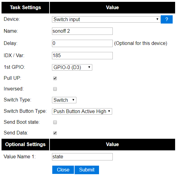

Try to change the name Sonoff 2 to button.
tontze
- Posts: 317
- Domoticz version: Beta Ch
- Location: Finland
Re: Sonoff Touch
Thnx ! that did it !

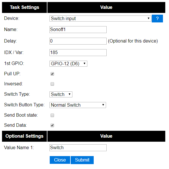

Re: Sonoff Touch
There is one problem. I want the code/rule to change the status of touch also if the relay status changes to the same status as relay is in.
This is because if you remote execute the code:
http://ip/control?cmd=GPIO,12,0
Only the status of the relay changeses. The status of the touch stays in this case 1. So this causes the problem that the touch button has to be press twice; first will not react because it will only change the status to the same one as the relay is and the second press will then eventually turn on or off the light.
The rules i have are:
P.S.:
The above code is fixed now and it works with refreshing also the touch state.
How can i achive that the touch status will always be the same as the relay one.
on touch#switch do
if [touch#switch]=1 do
gpio,12,1
gpio,12,0
endif
endon
on relay#switch do
if [relay#switch]=1 do
gpio,13,1
inputswitchstate 0,1
gpio,13,0
inputswitchstate 0,0
endif
endonThe above code is fixed now and it works with refreshing also the touch state.
