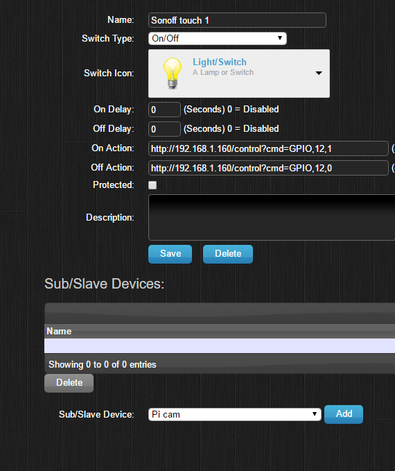

As I stated before I am very new and trying things out. Flashing worked. I can activate the ligth by hardware switch and from Domoticz. But somehow (I really don't know why) if I switch it manually the status in Domoticz won't change. Used some info from sincze
On action Domoticz:
I could really use some help. Who can?
On action Domoticz:
http://192.168.1.160/control?cmd=GPIO,12,1-

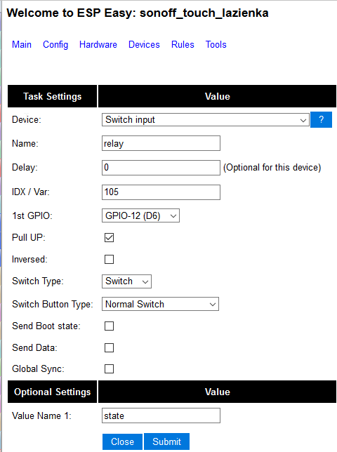

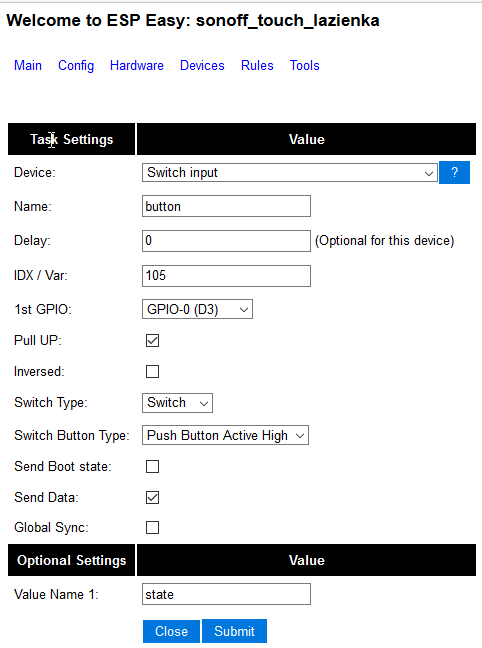

That's my config.

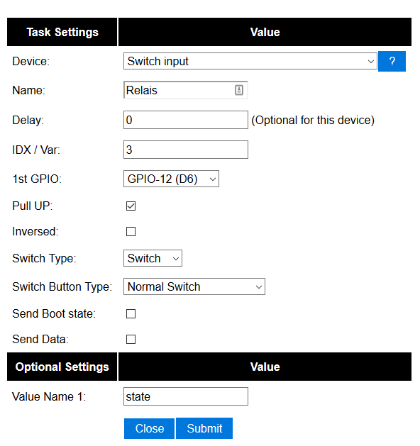

- Eddiever
- Posts: 105
- Joined: Thursday 27 April 2017 20:32
- Domoticz version: 2022.1
- Location: The Netherlands (Hoogeveen)

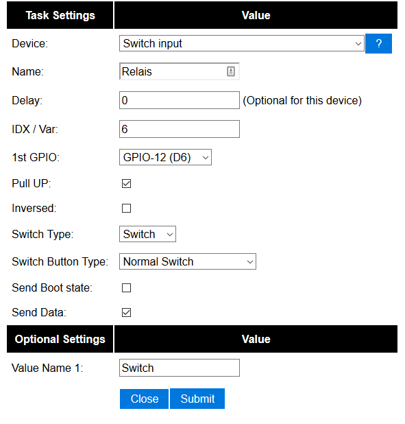

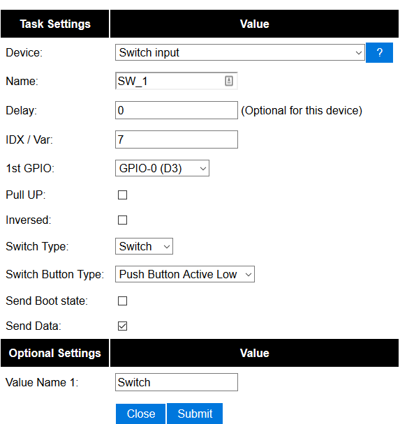

Re: Sonoff Touch
Sorry mayyam, thought the code was from sincze.
Even if I set it up exactly like your example the state doesn't change within Domoticz. The IDX variable was wrong in my case. In Domoticz it has the value of 3. I changed that in both ESP devices.
From Domoticz: What kind of stupid thing I am overlooking?
mayyam
- Posts: 47
- Joined: Saturday 14 January 2017 11:29
- Domoticz version: 4.11333
- Location: Poland
Re: Sonoff Touch
On ESPEasy, in button device You have to give idx of realay device in domoticz and check "Send data" chceck box.

- Eddiever
- Posts: 105
Re: Sonoff Touch

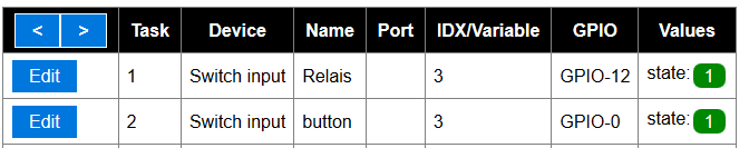

Changed it to 3 but still no state change when manually switched
mayyam
- Posts: 47
- Location: Poland
Re: Sonoff Touch
Do You have "Send data" checked?

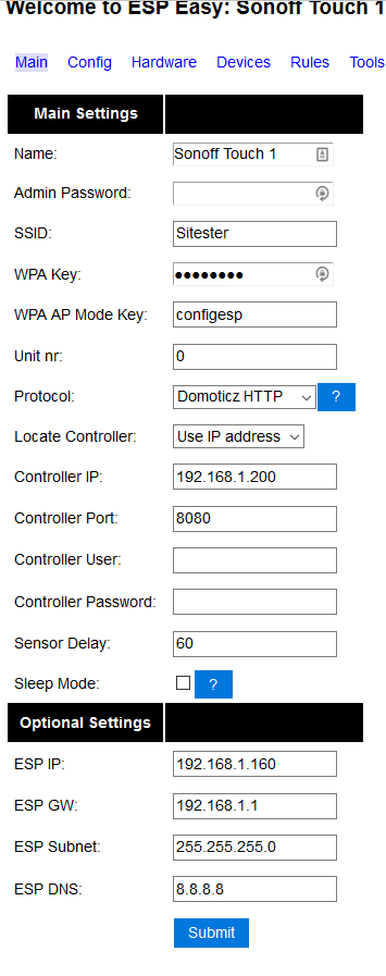

- Eddiever
- Posts: 105
Re: Sonoff Touch
The config:
mayyam
- Posts: 47
- Location: Poland
Re: Sonoff Touch
If Your Domoticz server is 192.168.1.200, and port is 8080 it looks right to me.

mayyam
- Posts: 47
- Location: Poland
Re: Sonoff Touch
Right.
I Have no Domoticz password, so my Controller User and Controller Pass fields are empty, but maybe You have to fill them ?

- Eddiever
- Posts: 105
Re: Sonoff Touch
Oh mayyam, how great (and stupid of me). That is it. Username/password. Darn me.
Thank you so much for your quick reply and help!
