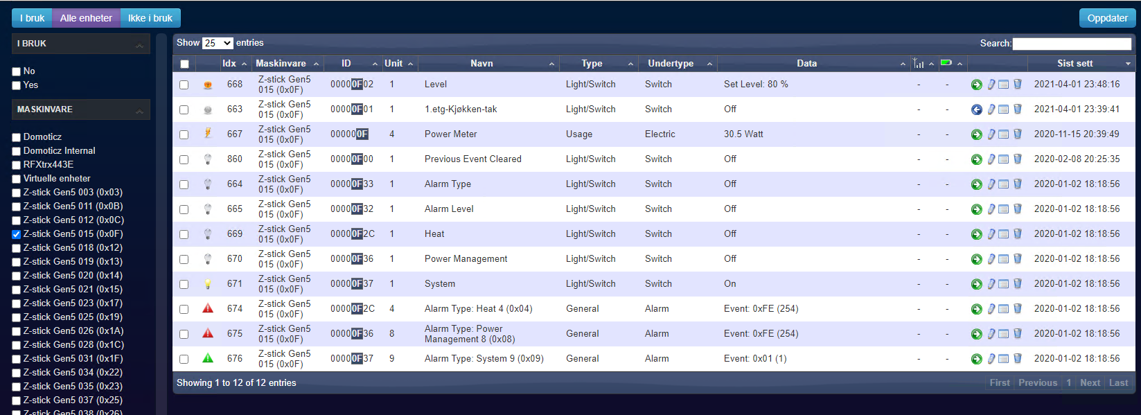

I'm amazed that this is not part of Domoticz (anymore), and how hard it is to actually find zwave devices that belongs to the same unit. So I implemented a quickfix on top of Version: 2020.2 (build 12660) (I guess it will work on latest as well).
Now each z-wave device/unit is listed as a separate hardware, and selecting the z-wave device/unit (hardware) will filter the list for all related domoticz devices. It's possible to select multiple z-wave devices/units simultaneously.
I can make a PR if it's interesting to get this addition merged. No guarantee it will get accepted though.

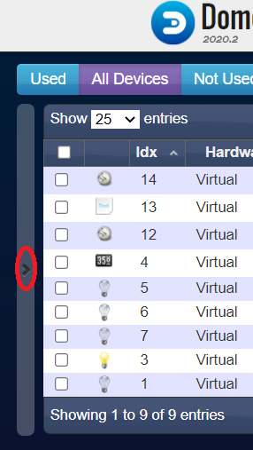

I am now on 2021.1. How can I get the mixed device/hardware tab. In devices tab, I can only see the devices, idx are highlighted. But I don‘t see the hardware list as it is shown in the picture above in this thread.
Re: Confused about which device belong to which zwave-node
harrykausl wrote: Thursday 20 May 2021 22:43 I am now on 2021.1. How can I get the mixed device/hardware tab. In devices tab, I can only see the devices, idx are highlighted. But I don‘t see the hardware list as it is shown in the picture above in this thread.
select bar.png (42.88 KiB) Viewed 1700 times

waaren wrote: Thursday 20 May 2021 22:47 ...
Also searched a bit for this one :)
Looks this does not always show all devices in a z-wave node: Using this bar only shows relay control from my Qubino Smart-Meter... But search using the old hex node ID method still shows all devices (V/I/W/Cos Phy...). Others I checked (not all) looks OK.
Can't see how to put an image (needs an external URL) directly in the forum to show this, but that's what's happening.
