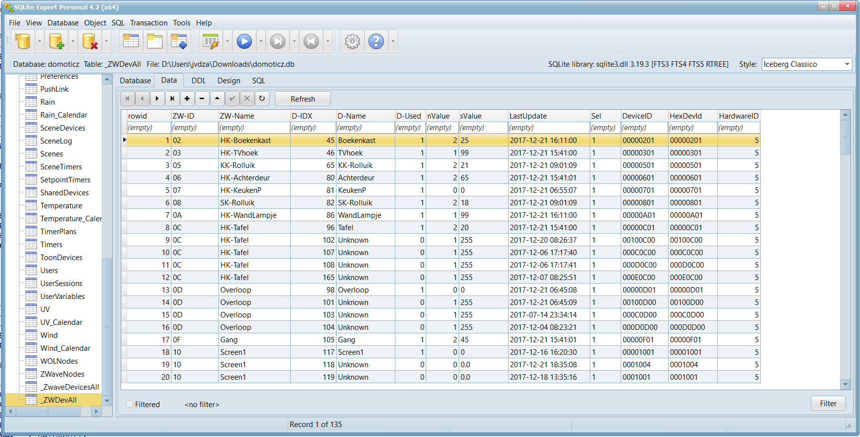

Bostjan wrote: Friday 22 December 2017 1:13 Hi to all,
I've looked at source code a little bit and found out why no one explains how devices get theirs deviceID - because it's so damn complicated.
I have actually done the same yesterday and looked for some logic to generate 2 Views in SQLLIte Expert Personal.
What I did was create this SQL which you can run against a saves domoticz DB. Open this saved database in SQLLIte Expert Personal, just copy& past it into the SQL TAB when you selected the Database and hit "Execute SQL".
EDIT: NEXT POST CONTAINS AN UPDATED VERSION... SO YOU MIGHT WANT TO SKIP THIS PART:
A couple of views will be created:
  • ZwaveHardwareId -> will contain the ZWAVE Hardwareid(s) used for selection of the ZWAVE devices
  • ZwaveNodes_Temp -> Adapted view of ZwaveNodes also containing the HEX value for the NodeID
  • ZwaveDevicesAll -> All Devices found from the Domoticz Devices table
  • ZwaveDevicesOK -> All Devices found from the Domoticz Devices table ordered on ZWAVEID and ZWAVE Name
  • ZwaveDevicesWrong -> All Devices found from the Domoticz Devices table That have a none existing ZWAVEID, so are likely the remainders from removed ZWAVE devices.
-- create table that contains the HardwareID's for ZWAVE
DROP VIEW IF EXISTS ZwaveHardwareID;
CREATE VIEW ZwaveHardwareID
AS
SELECT DISTINCT [HardwareID]
FROM   [ZwaveNodes];
-- create table that contains all ZWAVE devices and the hex version of the NodeID to use for matching
DROP VIEW IF EXISTS ZwaveNodes_Temp;
CREATE VIEW ZwaveNodes_Temp
AS
SELECT [NodeId],
       PRINTF ('%02X', [NodeId]) AS "U2",
       [Name],
       [HardwareID]
FROM   [ZwaveNodes];
-- create table that contains all Domoticz devices that below to the HardwareID's for ZWAVE
DROP VIEW IF EXISTS ZwaveDevicesAll;
CREATE VIEW ZwaveDevicesAll
AS
SELECT DISTINCT [DeviceStatus].[DeviceID],
                [DeviceStatus].[Id],
                [DeviceStatus].[Used],
                [DeviceStatus].[HardwareID],
                [DeviceStatus].[Name],
                [DeviceStatus].[nValue],
                [DeviceStatus].[sValue],
                [DeviceStatus].[LastUpdate]
FROM   [DeviceStatus]
       INNER JOIN [ZwaveHardwareID] ON [ZwaveHardwareID].[HardwareID] = [DeviceStatus].[HardwareID];
-- create table with Domoticz devices ordered by ZWAVE device
DROP VIEW IF EXISTS ZwaveDevicesOK;
CREATE VIEW ZwaveDevicesOK
AS
SELECT SUBSTR ([DeviceID], - 4, 2) AS "ZW-NodeID",
       [ZwaveNodes_Temp].[Name] AS "ZW-Name",
       SUBSTR ([DeviceID], 1, 4) AS "Dev",
       SUBSTR ([DeviceID], - 2, 2) AS "Dev1",
       [ZwaveDevicesAll].[Name] AS "Dev-Name",
       [ZwaveDevicesAll].[Id] AS IDX,
       [ZwaveDevicesAll].[Used],
       [Hardware].[Id],
       [Hardware].[Name] AS "H-Name",
       [ZwaveDevicesAll].[DeviceID],
       [ZwaveDevicesAll].[nValue],
       [ZwaveDevicesAll].[sValue],
       [ZwaveDevicesAll].[LastUpdate]
FROM   [ZwaveDevicesAll]
       INNER JOIN [Hardware] ON [Hardware].[Id] = [ZwaveDevicesAll].[HardwareID]
       INNER JOIN [ZwaveNodes_Temp] ON [ZwaveNodes_Temp].[HardwareID] = [ZwaveDevicesAll].[HardwareID] AND [ZwaveNodes_Temp].[U2] = SUBSTR ([DeviceID], - 4, 2)
WHERE  SUBSTR ([DeviceID], - 4, 2) <> "00"
       AND length([DeviceID]) > 5
UNION ALL
SELECT SUBSTR ([DeviceID], - 2, 2) AS "ZW-NodeID",
       "xx" AS "Dev1",
       [Hardware].[Id],
       INNER JOIN [ZwaveNodes_Temp] ON [ZwaveNodes_Temp].[HardwareID] = [ZwaveDevicesAll].[HardwareID] AND [ZwaveNodes_Temp].[U2] = SUBSTR ([DeviceID], - 2, 2)
WHERE  [Hardware].[Name] = "ZWAVE"
       AND SUBSTR ([DeviceID], - 4, 2) = "00"
UNION ALL
SELECT SUBSTR (PRINTF ('%08X', [DeviceID]), - 4, 2) AS "ZW-NodeID",

Have been playing some more with this idea and now have a SQL set of statements that create a single new table called "_ZwDevAll" which will contain all needed information in one table:
New SQLCode which you can add to a BAckup copy of your domoticz.db like shown in the previous post:

-- create sorted table which contains all ZWAVE devices and their ZWAVE device info sorted on ZW-ID and IDX
DROP TABLE IF EXISTS _ZWDevAll;
CREATE TABLE _ZWDevAll
AS
SELECT *
FROM   [_ZWTempAll]
Order by [ZW-ID],[D-IDX]
-- remove temp table
DROP TABLE IF EXISTS _ZWTempAll;
Enjoy,
Jos
