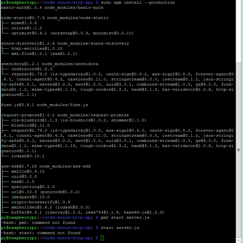

sorry but I am a complete noob out here.
I really like to use this feature for my domoticz setup but I am not getting any further.
so this is what I did.
>checked that I did have node version 4.0.0
>did the clone
>cd node-sonos-http-api
>sudo npm install --production
>> it installed without any error, assuming that I did the right thing.
but when I enter PM2 start server.js I get the following: command not found.

@Trigun
You need to jump into the sonos-http-api directory; then you can issue: pm2 start server.js

Hi Holland, thank you for your reply. but so far no luck. I did what you told but it doesn't seem to start.
below a screenshot of what I did.
Can you please help me out here?
Thanks in advance!
Thanks in advance!

@Trigun;
Have you installed PM2? It's not part of the Domoticz sd image, or Jessie Light
See http://pm2.keymetrics.io/docs/usage/quick-start/

Hi Holland, I got it working!Holland wrote:@Trigun;
NPM start did the job! (since I don't have PM2 running
next thing is to keep it running when I close the session.
sorry I am a huge noob with commandline. do you perhaps have any suggestions?

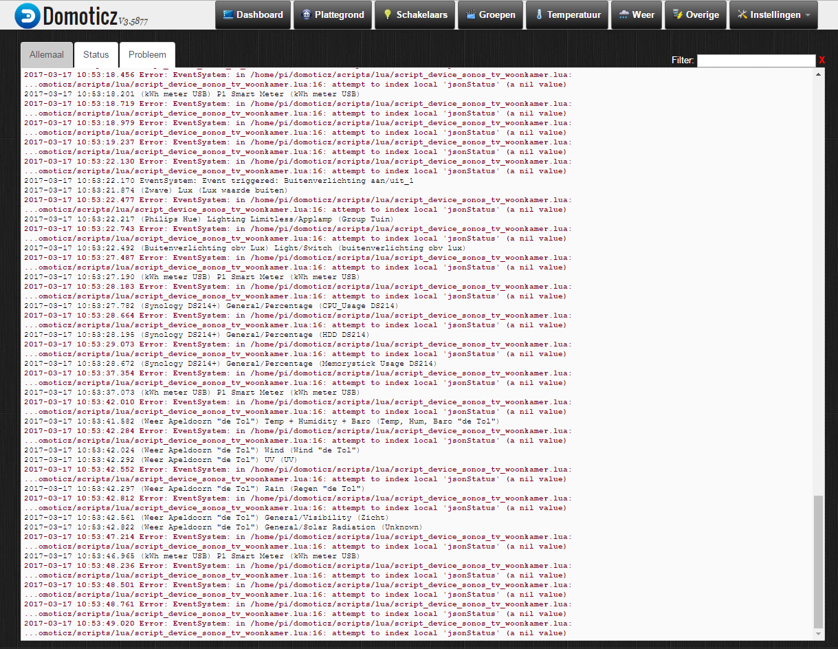

This is the log i get. It is still not working.
I put my script in attechment.
- script_device_sonos_tv_woonkamer.zip
- (1.12 KiB) Downloaded 176 times

Yes i get status "error". I use the ip of my domoticz. If i use the ip of my sonos playbar the site is not available.
Something is wrong, but i don't know what.
