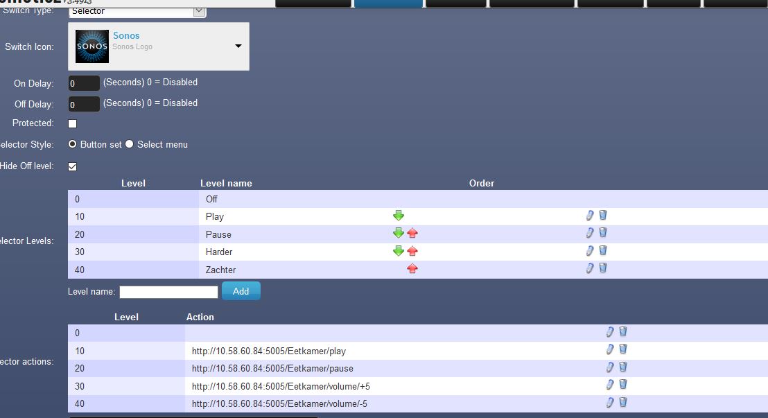

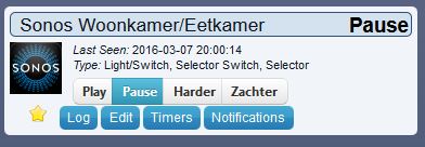

9. Create a selector switch (create a dummy device and pick selector switch in the list of virtual devices ) according to the below images;
I also created a functionality to extract a json string from the sonos. This way I can check the status of the sonos. E.g If always would like to pause the sonos when the tv is switched on. So the below script checks first if the Sonos is playing. If the tv is switched on, then the Sonos is paused. Keep in mind the below json script is just a way to show what is possible with json.
One if the things I would like, is to show some of the below json output on the selector switch. This way the selector switch shows e.g the artist or radio station that is playing. I have posted that issue over here, but the problem is still there; https://www.domoticz.com/forum/viewtopi ... 28&t=10689
Secondly I would also like to update the the selector switch according to the current status. E.g Pause button is active when in pause mode, and the play button is active is active when in play mode, even when the sonos is e.g paused outside of Domoticz. But to be able to do that I need a general on and off action feature, which can control the whole selector switch via a json script

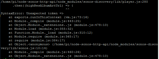

I really liked the way that Jishi implemented the http-api however when I install and run this I get error when i run the server.js
anyone having any ideas?

What version of Node have you running. At least version 4.0.0 is required
I have the following;
pi@raspberrypi ~ $ node -v
v5.6.0
If outdated do the following;
http://blog.wia.io/installing-node-js-v ... spberry-pi
