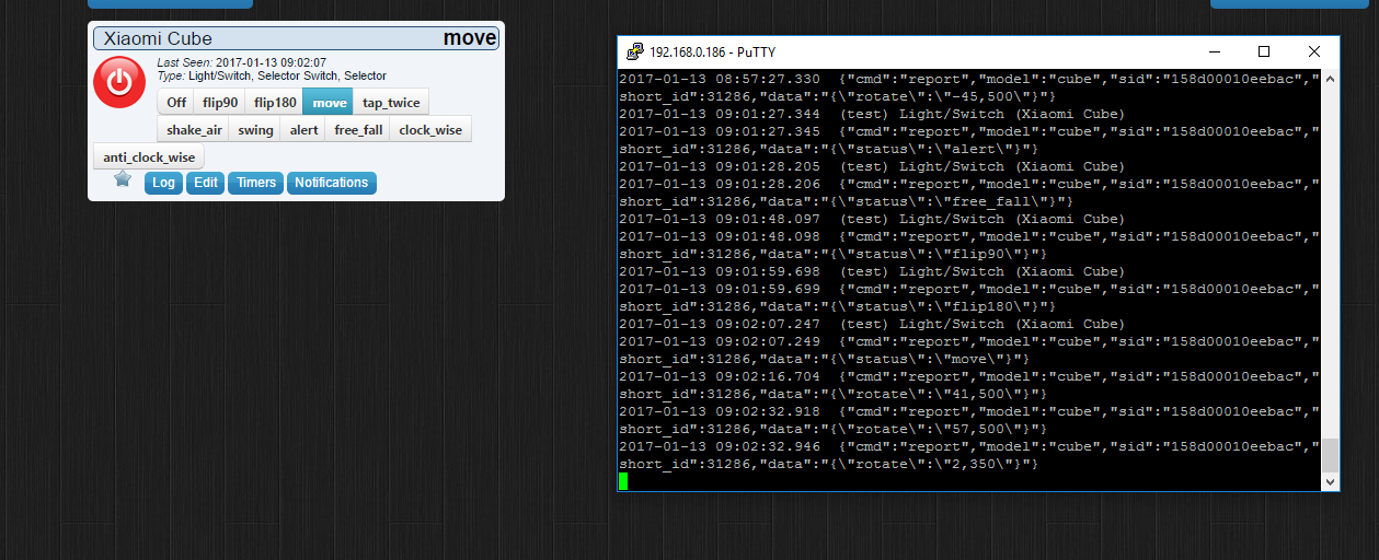

deennoo wrote: Maybe disable auto off for cube and round switch, a switch never turn off it just state change (clik, long clik etc) same for cube each mouvement is a new one
Try https://github.com/corbinmunce/domoticz for the rotate command handling - I haven't changed the on/off status part, you can easily adjust the source though.

deennoo
Posts: 784
Location: Bordeaux France
Post by deennoo »
Just test "rotate", fonction are created on cube selector switch but they aren't linked to the gateway message. other fonction are ok
