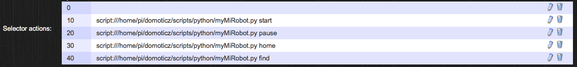

#!/usr/bin/python
import socket
import sys
import codecs
UDP_IP = '192.168.100.18'
UDP_PORT = 54321
INET_ADDR = (UDP_IP,UDP_PORT)
action = str(sys.argv[1])
massage = "213100500000000002f2c97b5872"
if action == "start":
message_to_send = massage + "2fd096c280746dc2091bad1d30c49ce74da6c88492a5c0e7c427ad0b4ca98c3b08ea35e67b29dddd8624dd1f2ea46ced68fce3c5b7fef8e89eef60b3c777f43a5622"
if action == "pause":
message_to_send = massage + "3080fdc4d67fe6fd048b63eb6d2cee5f285f8fec54c2e3bc5486641ec620bae160e9717af4d17ce3c0265bcb807644dae475bcaaf089391f6f76fa85b31396af3e26"
if action == "home":
message_to_send = massage + "30e4006525a8e0420c337fbc2bfc1741369bb9760685aafe250790ee4ea8bda3aafbdfaa47ae0e8518503530fb72579fe8cf334c6a6fcd4cbc94bfb310f64163a80a"
if action == "find":
message_to_send = massage + "29d24b61f9c826221c4c7a68be606ff324f81fcc282e18fa679d0506e3e805cbfe56323f2dc292f5d609d20782cb6df1abe3b4a9ce062da42e3371126048c2213b3e"
message_to_send = codecs.decode(message_to_send, "hex_codec")
sock = socket.socket(socket.AF_INET, socket.SOCK_DGRAM)
sock.sendto(message_to_send, INET_ADDR)-

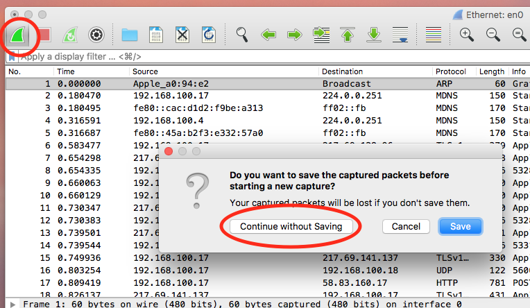

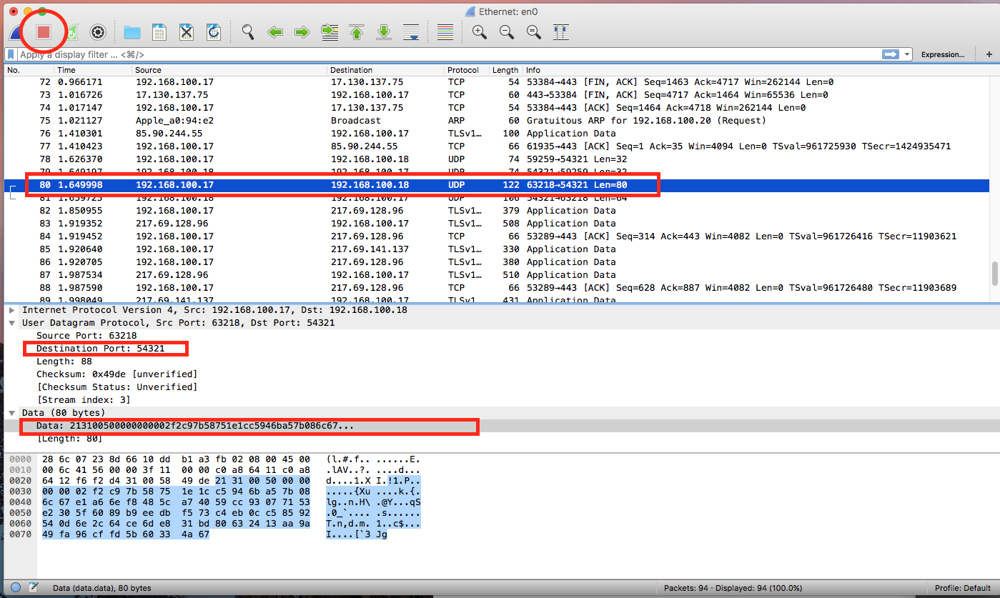

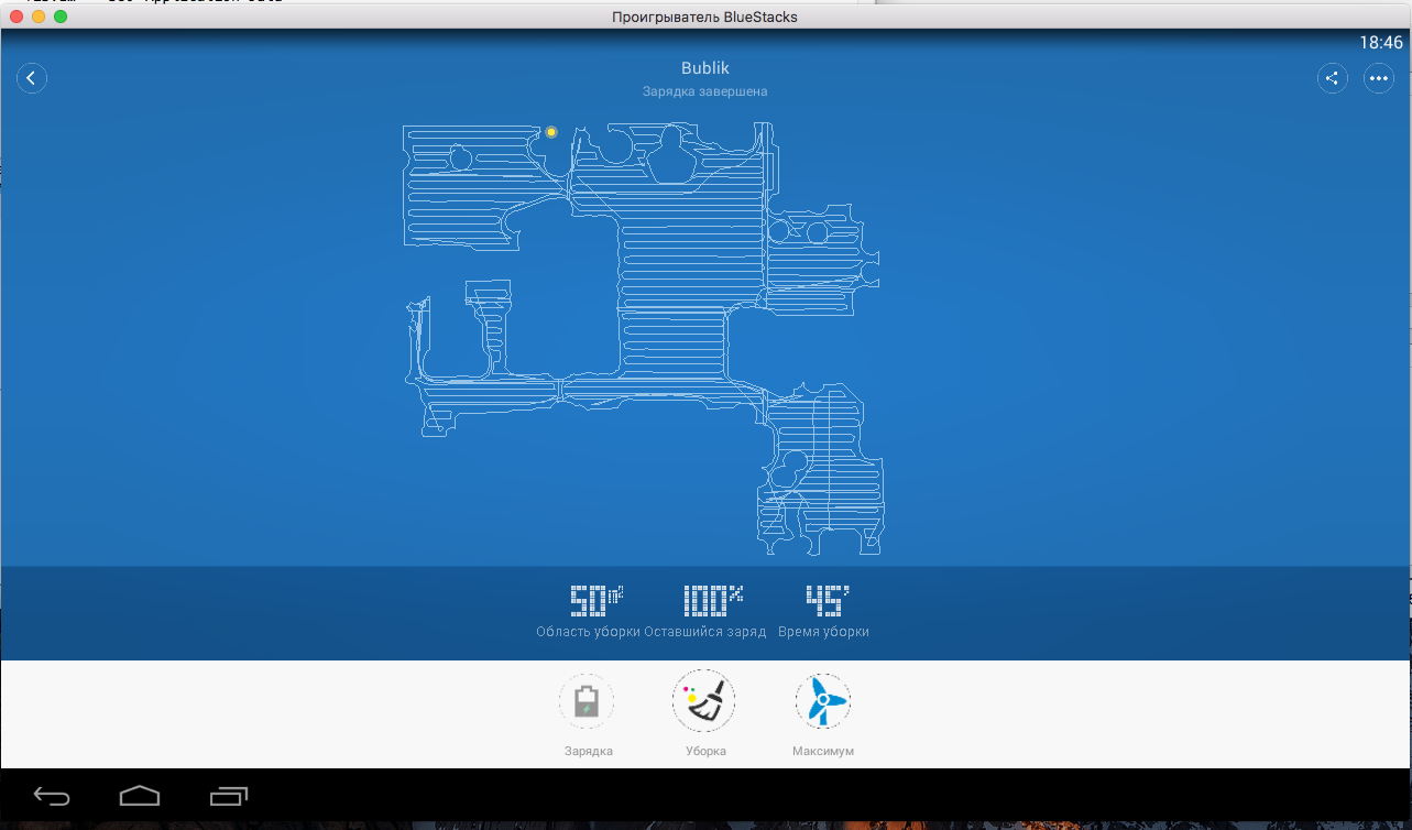

Install BlueStacks on PC (Mac)
Install MiHome app on BlueStacks and connect Mi Robot On MiHome see ip adress Mi Robot
Run vereschark and select interface network PC Run intercept packets

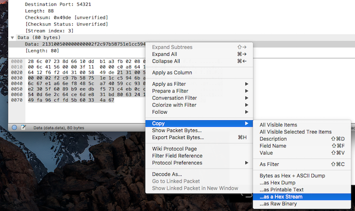

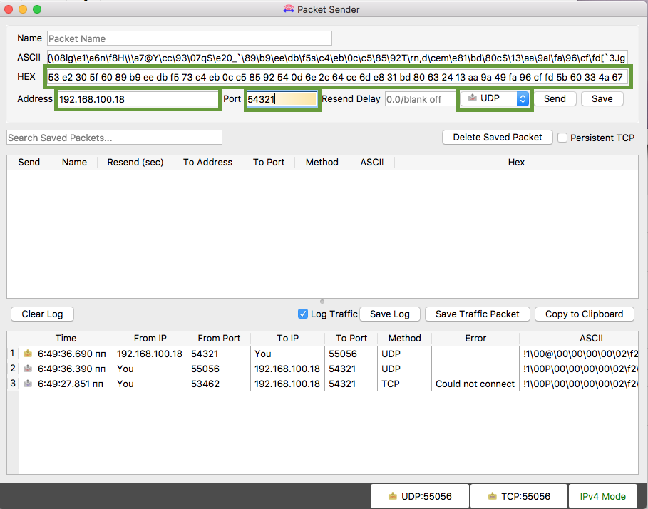

Click on MiHome search devices
and stop on vereschark intercept packets
search packets ip PC to ip Mi Robot Copy data Run PacketSender
Paste ip, port, protocol, data And send
If the robot will respond - excellent!
The required package is found
analogously other commands

Sevift wrote:For example, a vacuum cleaner Searchn1c0l45 wrote: I should receve my mi robot soon, could you give me some informations to catch packets with wireshark? So that I could check if command are te same?
thanks
