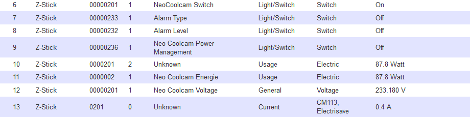

Received and added Neo Coolcam powerplug. But can someone explain all the devices and how to use them?
I can use the switch, but have no idea what to do with the rest

As the users manual clearly explains, the power plug is able to monitor your energy consumption. So 10 or 11 (you'll see that after a day or so) will be your total consumption (in kwh), 11 is the current consumption (or the total, you'll see that), 12 is the current voltage while 13 is the current ampere.DarkAllMan wrote:neopp.PNG
