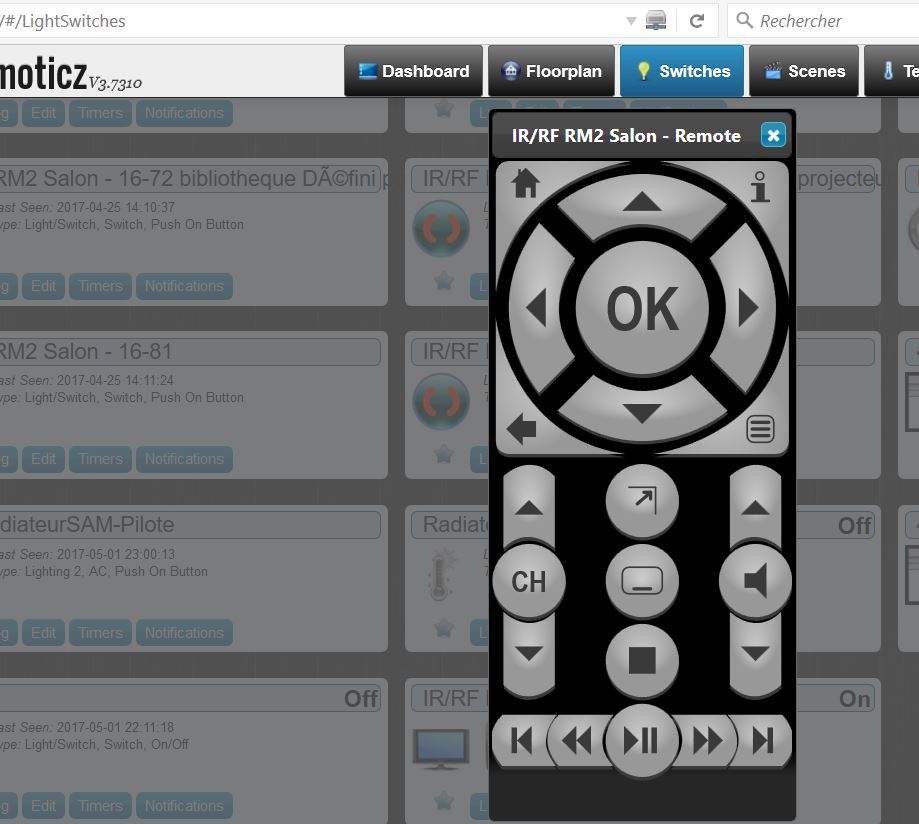

ToneStrife wrote:Hello everyone!
So probably my idea was wrong. I bought the RM2 pro thinkg that when importing from my phone (I have my hole TV remote) I would be able to add a Remote control easyly to domoticz.
Was I wrong? Now I have like 20 devices and I don0t know how to group them
On the next release (soon) you will have a Remote Control customizable...
ToneStrife
Posts: 20
Joined: Sunday 16 April 2017 17:02
Re: Using BROADLINK RM2 on DOMOTICZ
Post by ToneStrife »
Thanks!! Looks really cool!
