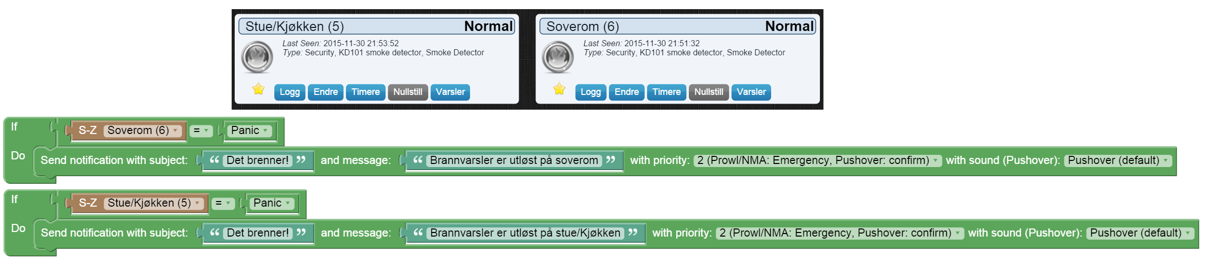

Sending E-Mail when smokedetector is detecting smoke:
EDIT: And turing on lamp:
also video:
https://sendvid.com/tqnqdxcc
