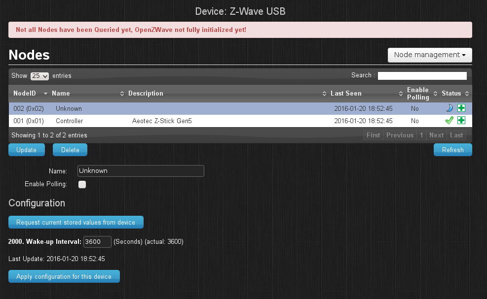

I suspect that one of my problems was a too low amp power supply as when the Z-Wave stick was being used, the RFCOMM started misbehaving too. I replaced a 1.2a with a 2.1a which should be sufficient.
I had tried doing the pairing using the pair button on the stick, and the flashing of the LEDs on both the sensor and the stick seemed to show that it had worked.
I plugged the stick back into my Pi and again went into Setup->Hardware, clicked on the stick and clicked on update. This did nothing. I tried changing the serial port back to ACM0 and Domoticz seemed to hang.
When I rebooted the Pi, and looked in Setup-> Devices, the USB stick now appears, which it never did before. However, the Fibaro sensor still doesn't appear.
Does anyone know what I need to do next?
When I went back in to Setup->Hardware and clicked on the 'Setup' button it now shows 2 nodes. One node is the USB stick,
However, the other node appears to be sleeping, and will not wake up. It also doesn't appear to be doing anything

Wait until that red warning goes away, new devices dont tend to be created until all nodes have responded.. sometimes it can take a lil bit.
Underpowered USB would cause all sorts of issues, might consider putting your transceivers on a powered hub.. there is only so much power the Pi's USB can output despite how much power is available at the input.

Just to let everyone know. After I updated the node details as described above, the devices finally appeared in Setup->Devices. It did take until the following day for them to appear though.
I'm guessing that changing the settings within the Fibaro device forced it to start reporting light and temperature levels, and once this happened, Domoticz added the devices.
