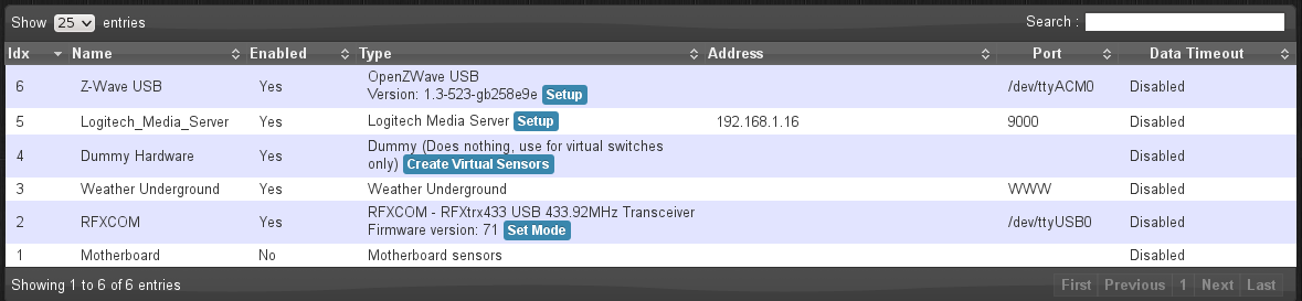

I've managed to set up a temperature sensor by going into Devices -> Dummy Hardware -> Create Virtual Sensor.
I then managed to set the temperature using a JSON call, which I will be able to integrate into the Python script that reads the sensor.

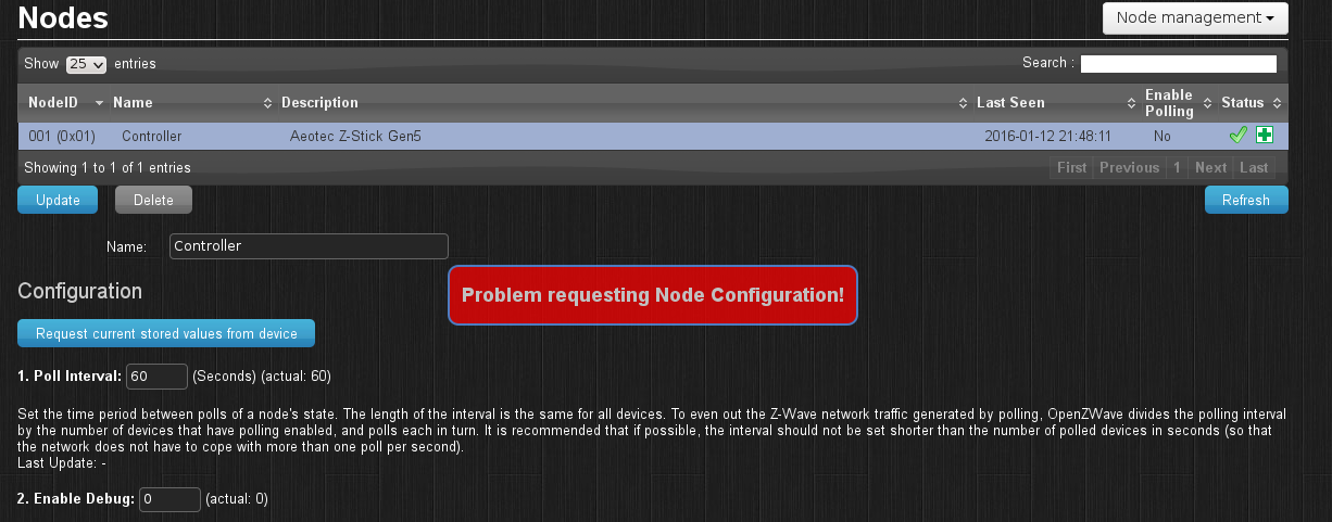

As part of this project I have purchased a Aeon Labs Z-Wave Gen5 USB stick and a Fibaro motion/temp/tamper sensor.
I believe that I've successfully paired these two devices. I then plugged the USB stick into my Domoticz system which is a RPi2 running the Domoticz IMG file that was current about November time when I rebuilt it.
I went into Setup -> Hardware and added the USB stick which appears to have worked However, the sensor did not appear in the Devices list.
Also, the USB stick is flashing it's LED Red, Blue, Yellow with about 1 second on each, which doesn't look right.
Lastly, when I tried to fumble my way round the settings and clicked on the "Request current stored values from device" I got a communications error
Can anyone tell me what I've done wrong, or what I need to do next please.
- nayr
- Posts: 354
- Joined: Tuesday 11 November 2014 18:42
- Domoticz version: github
- Location: Denver, CO - USA
Re: Domoticz, Pi, Z-Wave and heating
Go back to the setup -> hardware tab, click on your OpenZwave USB and click on update below.
This will force it to reload the config off the Z-Stick, you need to do this every time you unplug it and add new hardware.

Thanks for this. I've just done it again.nayr wrote:Go back to the setup -> hardware tab, click on your OpenZwave USB and click on update below.
Although I don't get any errors I also don't see any devices appear in Setup -> Devices. Is there something else I need to do?
