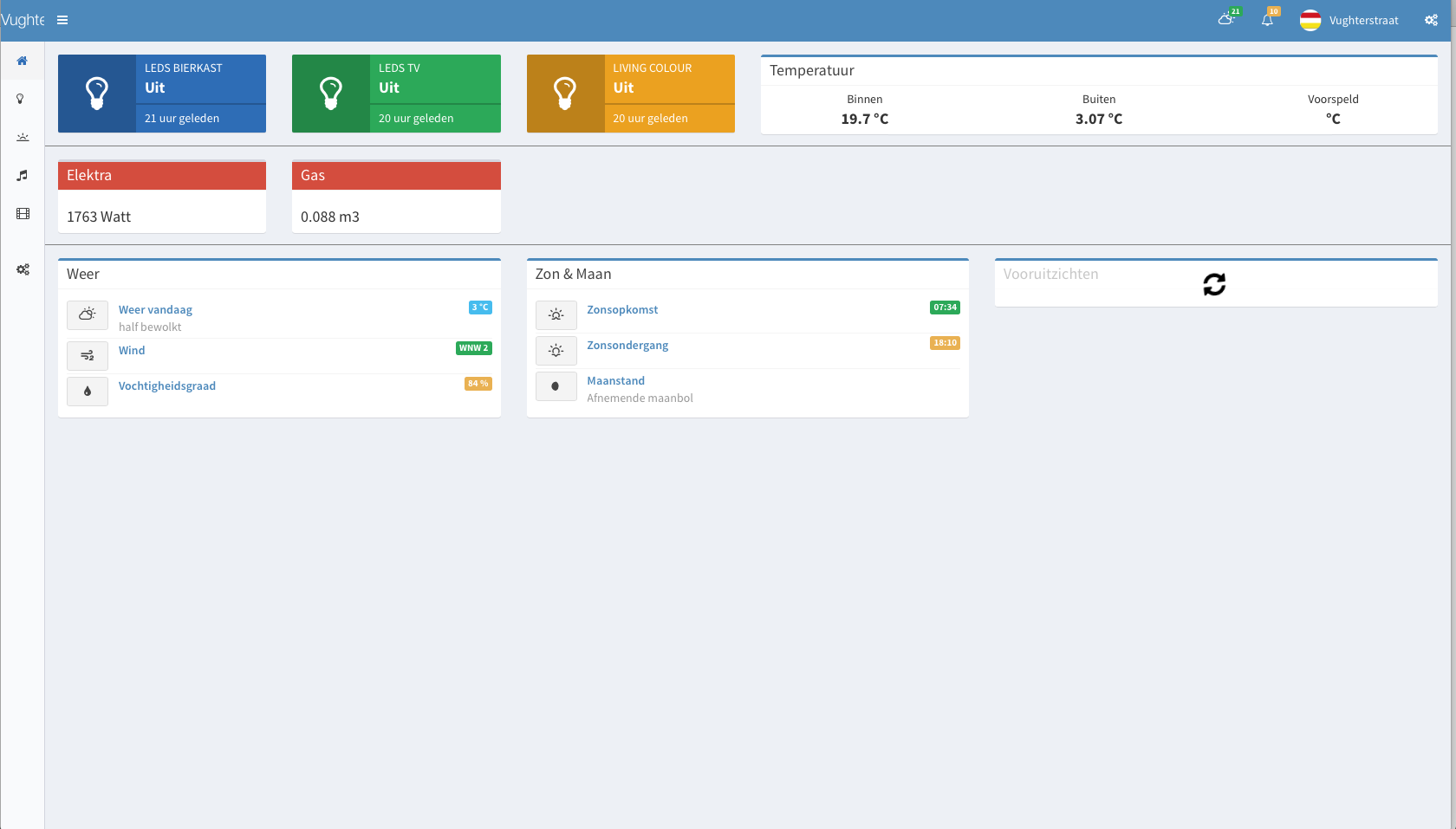

Yet another frontpage

verry nice frontpage. But I have kaku dimmers and these works in steps so when i use the slider the kaku dimmer respons only between 0% and 16% and from 16% it is alway 100% for the light. Is there a way to change this for kaku dimmers?

You have to define a new class, f.e. kakudimmers. See how the heaters are defined.

HansLe wrote:@arnoldg:
you have added this code to?
				} else if(element.hasClass("datavalue")) {
					that.updateWidget.datavalue(element, result);
Can you add the console log line:
		datavalue: function(element, result) {                // 1-2 toegevoegd
			var datavalue = result.Data ;
			console.log ( "Datavalue: " + result.idx + " " + result.Usage);
I use chrome to inspect what happens:
After changing the code
refresh the page with the box
right click your mouse
select inspect
select tab console
you see there the printed line? If not use some more console.log statements to investigate where it's going wrong.

I've just configured the Web Interface, and it's working great. But is their an example to configure / include a Chromecast and Selector Switches?

@arnoldg
Change line:
<div class="box" data-domoticz-id="60" data-status="true"">
to
<div class="box datavalue" data-domoticz-id="60" data-status="true"">
and it will work.
arnoldg wrote:i can't get it to work, below is the output of the json string.
i wan't to use ID:60 and the usage output.
that is not the problem, in domoticz.js a read this
         	var datavalue = result.Usage;
         // Update the datavalue itself
         eleme....
but it doesn't display the value to the screen, is there a way to see what is going wrong.
HTML code on the site
           		<div class="col col-md-2 col-sm-2 col-xs-2">
        				<div class="box-header box-solid box-info with-border bg-red ">
            				<h3 class="box-title">Elektra</h3>
			            </div><!-- /.box-header> -->
            		     <h4><div class="box-body datavalue">...</div></h4>
                 		<!-- /.box-body -->
		        	</div><!-- /.box -->
            	</div><!-- /.col -->
the rest is just as you descript.
please tell me what i do wrong.

Got the Gas and Electricity working. Thanks for the example @HansLe.

its verry nice, i have a tablet on the livingroom with this frontpage, my girlfriend likes it ;)
would be nice if there are people who can make extra things in. such as current temp a thermostat. as in my living room and barn.
attached a few pictures
