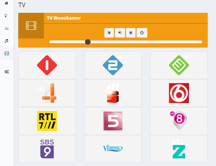

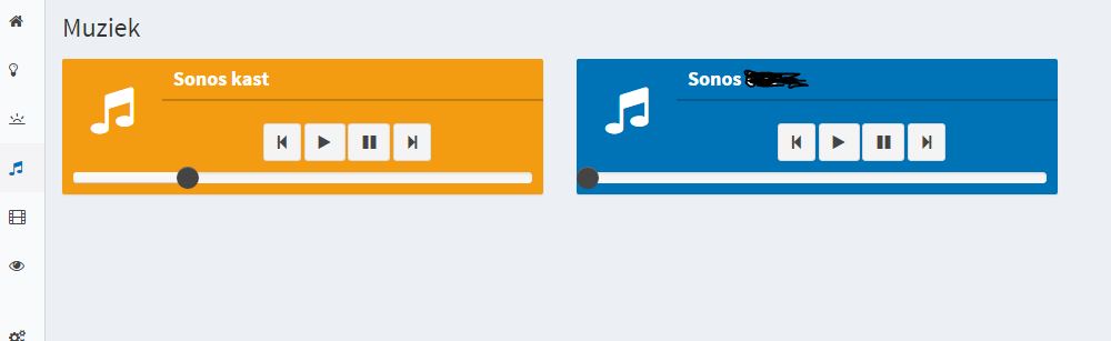

I've been working with domoticz for a few months now, and I was looking for a good way to control my devices from a tablet. As I didn't really like the looks of the existing frontpage.html solution, I decided to build some scripts within the AdminLTE template. I also included some basic support to control my chromecast and sonos systems, although that functionality doesn't have to do with domoticz.
The result looks like this
The responsive version can be used on smartphones:
Maybe someone else also likes the design, idea or code. You can find the code on github. Comments are appreciated as well, so I could improve the page.

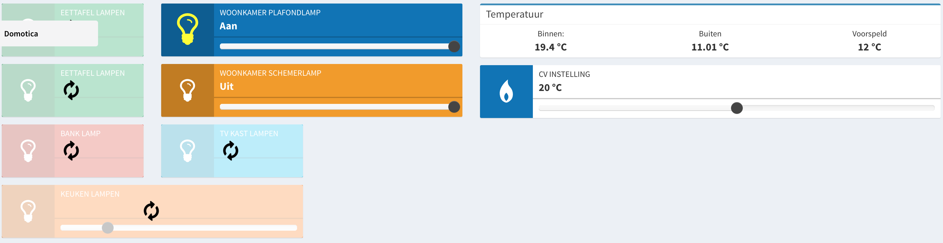

On of the nicest theme's i've seen so far. The only thing is, ordinary switches won't get updated.
They keep on rotating, witch is weird. Dimmers and my opentherm gateway are working fine though!

P.s. Although they keep in the "refreshing" state, clicking on them will actually work. So the IDX is treated properly.

Update: I think i've found the problem :) Roomplan did not contain those devices. :)
