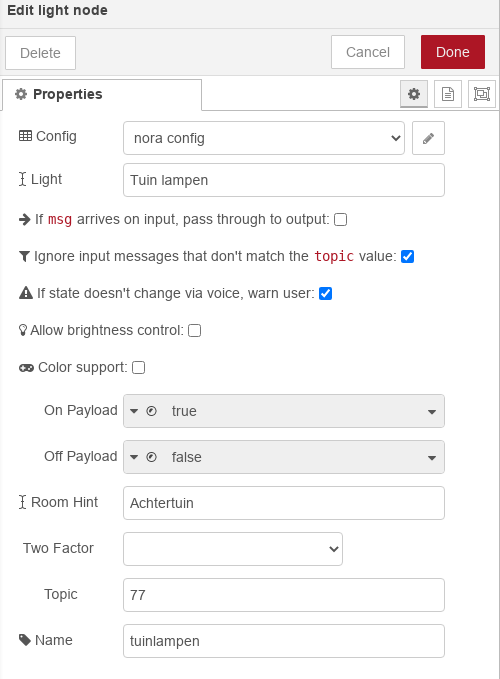

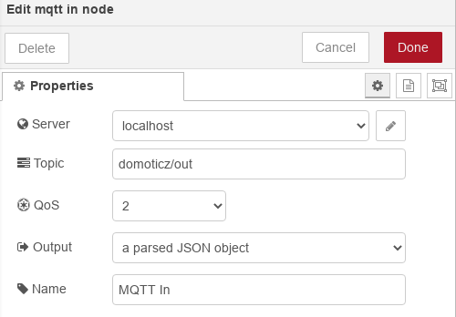

If you configure your MQTT Input node to what you expect, you do not need the JSON node to convert the message.
Choose the correct format: "a parsed JSON object".
Since version 1.0.12 the SmartNora nodes are able to filter on topic. This makes the Switch node obsolete.
But do not forget to tick the box.

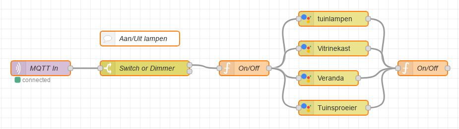

Please find the complete flow, as shown above, below:
At the output, you can connect a MQTT out node, with the topic domoticz/in and in parallel a Debug node.
Check at that node, if the format of the message to Domoticz is correct.
Check also with MQTT Explorer, as suggested by @Gravityz.
Let us know the result.
Best regards.
[{"id":"e30dbeea.95cfd","type":"switch","z":"22f5db58.ab19ec","name":"Switch or Dimmer","property":"payload.switchType","propertyType":"msg","rules":[{"t":"cont","v":"On/Off","vt":"str"},{"t":"eq","v":"Dimmer","vt":"str"}],"checkall":"true","repair":false,"outputs":2,"x":430,"y":4080,"wires":[["1d85b732.bcbef9"],[]],"outputLabels":["Switch","Dimmer"]},{"id":"1d85b732.bcbef9","type":"function","z":"22f5db58.ab19ec","name":"On/Off","func":"msg.topic = msg.payload.idx.toString();\n\nif (msg.payload.nvalue === 1) {\n msg.payload = true\n}\nelse if (msg.payload.nvalue === 0) {\n msg.payload = false\n}\nreturn msg;","outputs":1,"noerr":0,"initialize":"","finalize":"","libs":[],"x":630,"y":4080,"wires":[["2ef621d.53d9ade","47e77b76.ef57a4","7283506f.a453d","9ef26217.759c6"]]},{"id":"853cd08.4dd6a3","type":"function","z":"22f5db58.ab19ec","name":"On/Off","func":"var idx = parseInt(msg.topic);\nif ( msg.payload === true )\n{\nmsg.payload = { \"command\": \"switchlight\", \"idx\": idx, \"switchcmd\": \"On\" };\n}\nelse if ( msg.payload === false )\n{\nmsg.payload = { \"command\": \"switchlight\", \"idx\": idx, \"switchcmd\": \"Off\" };\n}\nreturn msg","outputs":1,"noerr":0,"initialize":"","finalize":"","libs":[],"x":990,"y":4080,"wires":[[]]},{"id":"7e9e473a.d90818","type":"comment","z":"22f5db58.ab19ec","name":"Aan/Uit lampen","info":"","x":420,"y":4020,"wires":[]},{"id":"9ef26217.759c6","type":"noraf-switch","z":"22f5db58.ab19ec","devicename":"Tuin sproeier","roomhint":"Achtertuin","name":"Tuinsproeier","passthru":false,"errorifstateunchaged":true,"nora":"5705755.560e78c","topic":"201","onvalue":"true","onvalueType":"bool","offvalue":"false","offvalueType":"bool","twofactorpin":"","filter":true,"asyncCmd":false,"outputs":1,"x":810,"y":4160,"wires":[["853cd08.4dd6a3"]]},{"id":"2ef621d.53d9ade","type":"noraf-light","z":"22f5db58.ab19ec","devicename":"Tuin lampen","lightcolor":false,"brightnesscontrol":false,"commandonlycolor":false,"turnonwhenbrightnesschanges":false,"passthru":false,"errorifstateunchaged":true,"statepayload":true,"brightnessoverride":"","roomhint":"Achtertuin","name":"tuinlampen","colortype":"hsv","nora":"5705755.560e78c","topic":"77","onvalue":"true","onvalueType":"bool","offvalue":"false","offvalueType":"bool","temperaturemin":"2700","temperaturemax":"5500","twofactorpin":"","filter":true,"x":810,"y":3980,"wires":[["853cd08.4dd6a3"]]},{"id":"47e77b76.ef57a4","type":"noraf-light","z":"22f5db58.ab19ec","devicename":"Vitrinekast","lightcolor":false,"brightnesscontrol":false,"commandonlycolor":false,"turnonwhenbrightnesschanges":false,"passthru":false,"errorifstateunchaged":true,"statepayload":true,"brightnessoverride":"","roomhint":"Woonkamer","name":"Vitrinekast","colortype":"hsv","nora":"5705755.560e78c","topic":"208","onvalue":"true","onvalueType":"bool","offvalue":"false","offvalueType":"bool","temperaturemin":"2700","temperaturemax":"5500","twofactorpin":"","filter":true,"x":810,"y":4040,"wires":[["853cd08.4dd6a3"]]},{"id":"7283506f.a453d","type":"noraf-light","z":"22f5db58.ab19ec","devicename":"Veranda","lightcolor":false,"brightnesscontrol":false,"commandonlycolor":false,"turnonwhenbrightnesschanges":false,"passthru":false,"errorifstateunchaged":true,"statepayload":true,"brightnessoverride":"","roomhint":"Achtertuin","name":"Veranda","colortype":"hsv","nora":"5705755.560e78c","topic":"317","onvalue":"true","onvalueType":"bool","offvalue":"false","offvalueType":"bool","temperaturemin":"2700","temperaturemax":"5500","twofactorpin":"","filter":true,"x":800,"y":4100,"wires":[["853cd08.4dd6a3"]]},{"id":"75cbfb4601992e30","type":"mqtt in","z":"22f5db58.ab19ec","name":"MQTT In","topic":"domoticz/out","qos":"2","datatype":"json","broker":"f9f13036.e28b58","nl":false,"rap":true,"rh":0,"x":220,"y":4080,"wires":[["e30dbeea.95cfd"]]},{"id":"5705755.560e78c","type":"noraf-config","name":"nora config","group":"","twofactor":"off","twofactorpin":"","localexecution":true,"structure":"Thuis"},{"id":"f9f13036.e28b58","type":"mqtt-broker","name":"localhost","broker":"127.0.0.1","port":"1883","clientid":"","usetls":false,"protocolVersion":"4","keepalive":"60","cleansession":true,"birthTopic":"","birthQos":"0","birthRetain":"false","birthPayload":"","birthMsg":{},"closeTopic":"","closeQos":"0","closePayload":"","closeMsg":{},"willTopic":"","willQos":"0","willPayload":"","willMsg":{},"sessionExpiry":""}]Check at that node, if the format of the message to Domoticz is correct.
Best regards.

Tried the flow , and lights goes on and off perfectly,
Thank you very much.

@Gravityz,
I expected that, as the flow did not change significantly.
The JSON conversion is now moved to the MQTT input node.
The filtering is moved to the SmartNora node.
But in principle it is the same.
I think that we will never know, what the problem of @edwin1234 was.
A tip:
You have NR version 2 installed have a look to the new Debug and Linter features.

Gravityz
- Posts: 755
- Joined: Wednesday 16 December 2015 19:13
- Domoticz version: 2026.3
Re: Smart Nora
ok thanks, will look at it.
regarding the new functionality in the smartnora nodes to filter out topics.
my guess is that when you use this functionality it will create a lot of workload on nora since every nodes gets multiple communication strings
If i leave the switch in place this will reduce this workload a lot
