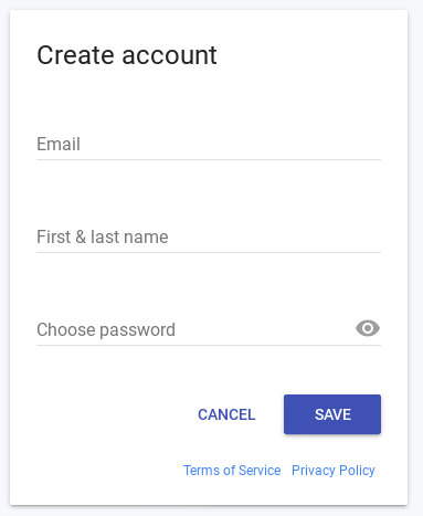

1. Register yourself at: https://smart-nora.eu/ and click in the right top corner on "My Nora".
It will ask you to create an account (Unless you already registerd before. In that case it will ask you for your previously selected password)
You will receive an email, which you have to confirm.
