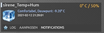

For the temperature/humidity, please provide logs, I need more less 15 minutes of logs , without I cannot really help.

pipiche wrote: Sunday 31 January 2021 11:39 For the temperature/humidity, please provide logs, I need more less 15 minutes of logs , without I cannot really help.
my log:
https://www.dropbox.com/s/knj40mxxiqxac ... e.txt?dl=0
This is very strange, wometimes the speaker has a soft "tik" when it is not in use.

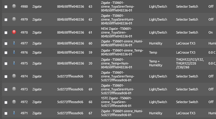

From what I saw in th export(1).json , it looks like the pairing was not done correctly.
Can you try to remove all devices in Domoticz, and then redo the pairing ? And then sending the expor.json of Plugin devices RAW (json)

redo paring done!

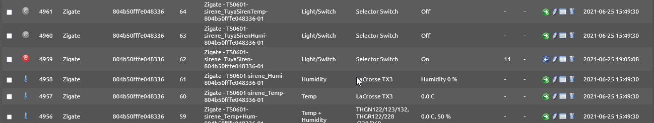

I did update and paring, but it is not working.

marktn
Posts: 232
Re: zigate tuya siren
Post by marktn »
I have found a difference between the sirens, the second one has the name Neo, the first one Neo coolcam. Maybe the problem...
I have charged the batteries of my first siren, with my second siren. (The first siren does not charge the batteries)
The first Siren is working, second one not.
So the first Siren is working, maybe the second one is another type/version.
Or the second one is also broken...
e4d3
804b50fffe048336
TS0601-sirene
Zigate - TS0601-sirene_Temp+Hum-804b50fffe048336-01
Zigate - TS0601-sirene_Temp-804b50fffe048336-01
Zigate - TS0601-sirene_Humi-804b50fffe048336-01
Zigate - TS0601-sirene_TuyaSiren-804b50fffe048336-01

The new (second) siren is not working, attached the logs. No siren, no temp and hum.
Also the new siren is flashing, see a video of it. https://www.dropbox.com/s/aqct67bvnus85 ... n.mp4?dl=0
The frist siren is still working fine, only has a problem with charging. Not a problem of zigate or domoticz. It looks like a charging problem.
