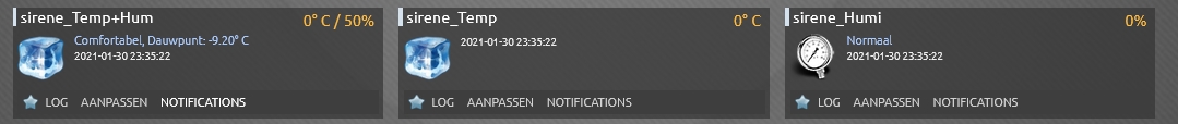

Temperature stays 0, i know it is a test version. :D

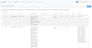

Parameters:
{'Alarm1': {'Duration': 5, 'Volume': 2, 'Melody': 1}, 'Alarm2': {'Duration': 5, 'Volume': 2, 'Melody': 2}, 'Alarm3': {'Duration': 5, 'Volume': 2, 'Melody': 3}, 'Alarm4': {'Duration': 5, 'Volume': 2, 'Melody': 4}, 'Alarm5': {'Duration': 5, 'Volume': 2, 'Melody': 5}, 'HumidityMinAlarm': 25, 'HumidityMaxAlarm': 75, 'TemperatureMinAlarm': 3, 'TemperatureMaxAlarm': 27}

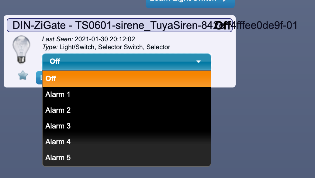

This should work, basically you have a Switch Selector created with 5 Alarms by default they are configured like that
Screenshot 2021-01-30 at 20.13.38.png (85.18 KiB) Viewed 3019 times
{'Alarm1': {'Duration': 5, 'Volume': 2, 'Melody': 1}, Melody 1 with lowest sound possible ( Max is 0 ) and duration 5 secondes
Now, if you want to update one of those 5 alarms, you just have to update the values
Duration: number of secondes
Volume: 0 Max 90db, 1 medium 80db, 2 low (70db)
Melody: 1 to 15
Update those via the Web Admin

temp stays 0
