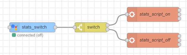

Here an update.
I gave up on the dummy switch solution.
Instead I've installed Node-RED with NORA plugin. I've created a switch which then executes a shell script. Works like a charm

@Droid.
In principle, I do exactly the same.
However, because CATT and Node Red run on different hardware, I push the command with MQTT to the machine with CATT installed.
Indeed, that works like a charm.
@Droid.
