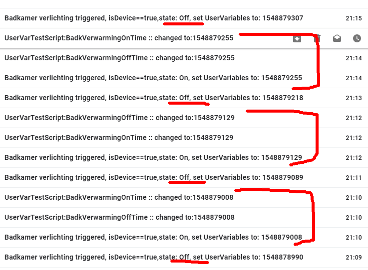

Here another test with the strange behaviour of the Z-Wave device and the expected behaviour of the "Badkamer verlichting2" dummy device;
Screenshot - 31_01_2019 , 08_58_02.png (51.92 KiB) Viewed 1029 times

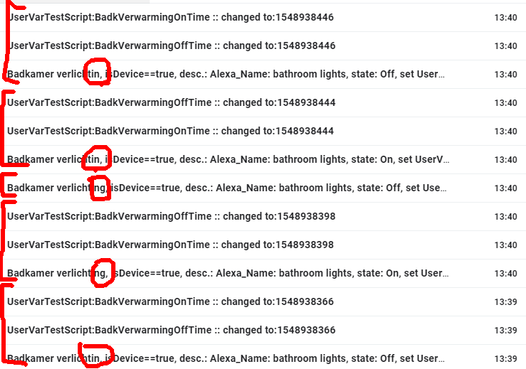

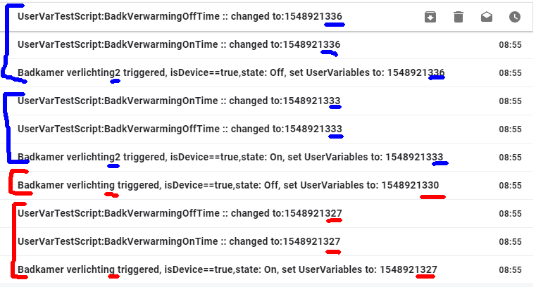

Looks like it has something to do with the lenght of the devicename;
Devicename "Badkamer verlichtin" is working is expected
Devicename "Badkamer verlichting" is not working as expected
Screenshot - 31_01_2019 , 13_41_46.png (64.79 KiB) Viewed 1021 times

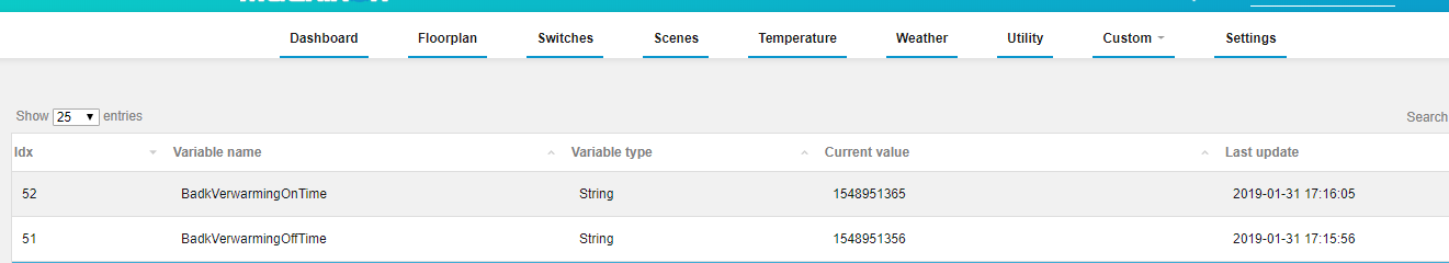

2019-01-31 17:15:56.622  (Virtual2) Light/Switch (isDevice Test with quite a very long name)
2019-01-31 17:15:56.866  Status: dzVents: Info:  Handling events for: "isDevice Test with quite a very long name", value: "On"
2019-01-31 17:15:56.866  Status: dzVents: Info:  isDevice check: ------ Start external script: dumper103.lua: Device: "isDevice Test with quite a very long name (Virtual2)", Index: 1477
2019-01-31 17:15:56.868  Status: dzVents: Debug: isDevice check: triggered by isDevice Test with quite a very long name; state: On; isDevice        true
2019-01-31 17:15:56.869  Status: dzVents: Debug: isDevice check: triggered by isDevice Test with quite a very long name; state: On; isVariable      false
2019-01-31 17:15:56.869  Status: dzVents: Debug: isDevice check: triggered by isDevice Test with quite a very long name; state: On; isScene         false
2019-01-31 17:15:56.869  Status: dzVents: Debug: isDevice check: triggered by isDevice Test with quite a very long name; state: On; isGroup         false
2019-01-31 17:15:56.869  Status: dzVents: Debug: isDevice check: triggered by isDevice Test with quite a very long name; state: On; isTimer         false
2019-01-31 17:15:56.869  Status: dzVents: Debug: isDevice check: triggered by isDevice Test with quite a very long name; state: On; isSecurity      false
2019-01-31 17:15:56.869  Status: dzVents: Debug: isDevice check: triggered by isDevice Test with quite a very long name; state: On; isHTTPResponse  false
2019-01-31 17:15:56.869  Status: dzVents: Debug: isDevice check: setting uservar BadkVerwarmingOffTime to 1548951356
2019-01-31 17:15:56.871  Status: dzVents: Info:  isDevice check: ------ Finished dumper103.lua
2019-01-31 17:15:56.883  Status: Set UserVariable BadkVerwarmingOffTime = 1548951356
2019-01-31 17:16:05.613  (Virtual2) Light/Switch (isDevice Test with quite a very long name)
2019-01-31 17:16:05.843  Status: dzVents: Info:  Handling events for: "isDevice Test with quite a very long name", value: "Off"
2019-01-31 17:16:05.843  Status: dzVents: Info:  isDevice check: ------ Start external script: dumper103.lua: Device: "isDevice Test with quite a very long name (Virtual2)", Index: 1477
2019-01-31 17:16:05.844  Status: dzVents: Debug: isDevice check: triggered by isDevice Test with quite a very long name; state: Off; isDevice        true
2019-01-31 17:16:05.844  Status: dzVents: Debug: isDevice check: triggered by isDevice Test with quite a very long name; state: Off; isVariable      false
2019-01-31 17:16:05.844  Status: dzVents: Debug: isDevice check: triggered by isDevice Test with quite a very long name; state: Off; isScene         false
2019-01-31 17:16:05.844  Status: dzVents: Debug: isDevice check: triggered by isDevice Test with quite a very long name; state: Off; isGroup         false
2019-01-31 17:16:05.844  Status: dzVents: Debug: isDevice check: triggered by isDevice Test with quite a very long name; state: Off; isTimer         false
2019-01-31 17:16:05.845  Status: dzVents: Debug: isDevice check: triggered by isDevice Test with quite a very long name; state: Off; isSecurity      false
2019-01-31 17:16:05.845  Status: dzVents: Debug: isDevice check: triggered by isDevice Test with quite a very long name; state: Off; isHTTPResponse  false
2019-01-31 17:16:05.845  Status: dzVents: Debug: isDevice check: setting uservar BadkVerwarmingOnTime to 1548951365
2019-01-31 17:16:05.846  Status: dzVents: Info:  isDevice check: ------ Finished dumper103.lua
2019-01-31 17:16:05.883  Status: Set UserVariable BadkVerwarmingOnTime = 1548951365
uservar set by isDevice test

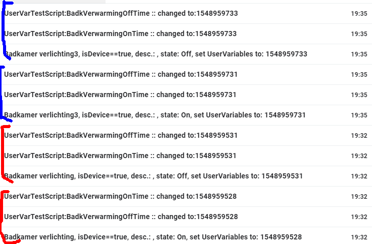

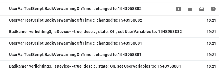

Don't known if its matter, but thats a virtual/dummy device and i'm using a Z-Wave device.
When I use a dummy device with the name "Badkamer verlichting3", then it's also working fine;
Screenshot - 31_01_2019 , 19_22_27.png (29.35 KiB) Viewed 1016 times
And the strange thing is... When I add a * the the "on" trigger in the script; "Badkamer verlichting*" both
Z-wave "Badkamer verlichting"
and
Dummy "Badkamer verlichting3"
are working as expected...
