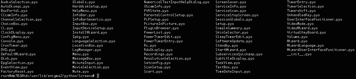

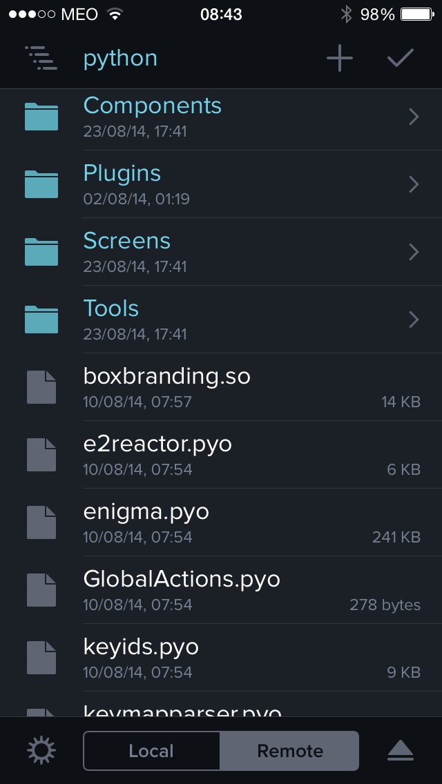

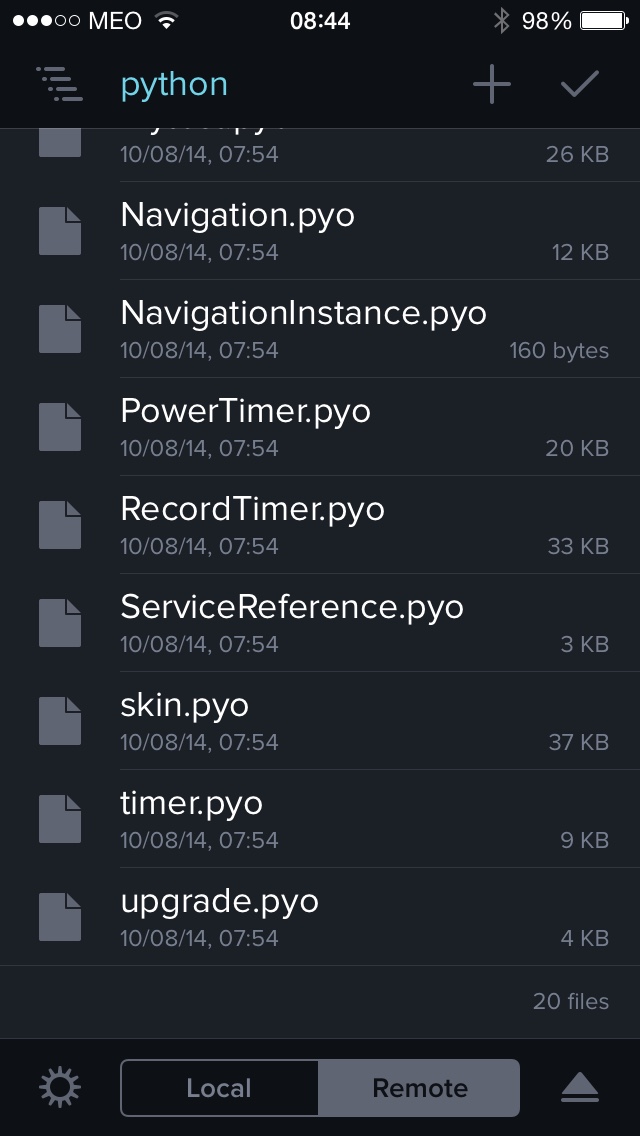

Sure, here they are:
D'rMorris
Posts: 138
Joined: Thursday 01 May 2014 9:01
Location: Netherlands - Sittard
Re: Checking Dreambox state
Post by D'rMorris »
That's the python folder :-). Now the contents of the Screens subfolder please ;-).
