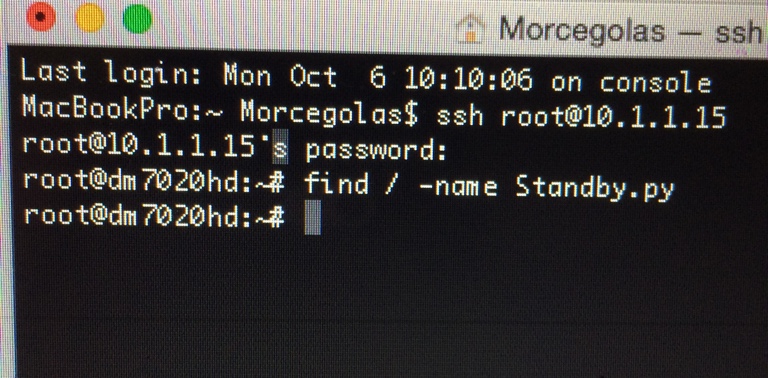

D'rMorris wrote: ...
Then in the directory /usr/lib/enigma2/python/Screens, there is a script called Standby.py. In this script, I added (made bold what I added):
I have Standby.pyo :/ can't edit that on vi, Using Dreambox 7020HD with Openatv 4.1.
Hope you can help me.
Thanks.

Post by D'rMorris »
the .pyo files are the ones that are compiled into .py during boot (as far as I understood).
If you do (in terminal / shell): find / -name Standby.py, do you get any results back?

None :/
