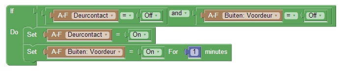

Ritmeester
- Posts: 53
- Joined: Thursday 06 March 2014 18:30
Re: Low cost window/door sensor
It is simple:BigDog wrote:if you want to let the door sensor switch someting wil it work or must it be made with a script becose the off command it gives..

- bizziebis
- Posts: 182
- Joined: Saturday 19 October 2013 14:00
- Domoticz version: 3.8805
If you do it like this it's actually switching a 'ON' switch to 'OFF' so it makes a little more sense:
The first time you activate the blocky event it will switch ON the light and change the switch status to ON. Every time you open the door it wil switch back the contact to OFF, the light will go ON for 1 minute and the contact is set back to ON.
