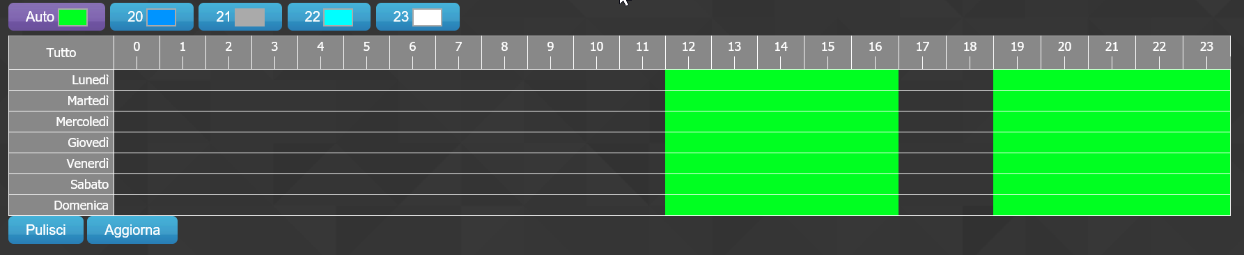

Unfortunatelly I updated to the last version of Domoticz Beta and the timers doesn't work! But you work is fantastic!

Just one point, on css part, I created only 4 colors. In your case, edit the style.css file, at the end there are classes .m0 .m1.. so add a .m4 and may be a .m5 class with the required color.

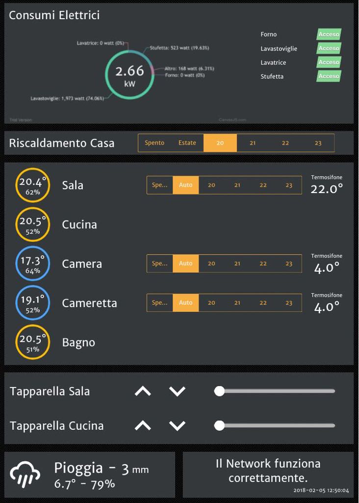

I'm creating a tablet dashboard for domoticz and I would like to insert your scheduler in this dashboard.
I'm not very practical in javascript, so I kindly ask you: you started from an example (you can give me the link) or you created it completely from zero (I'm dead :D )?
