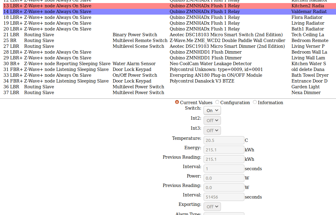

Is this really correct? The config file seems to me that it contains veeeery much information for that node, is it that advanced?
Why does this keep happening for me? :)
Or have I solved it by now?
It seems to show correct values for now, but it have changed instance numbers for the sensors, so I don´t know which is which.
But I can live with that, it´s easy to check.
I tried to paste the whole "node 55" config from zwcfg, but that was too many characters for the forum.
