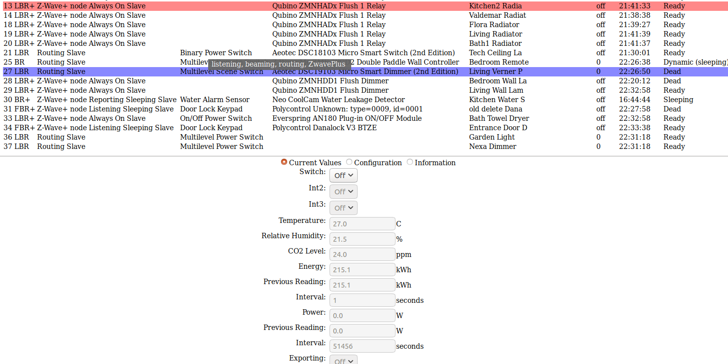

I am running Domoticz 4.97 under Raspbian on a raspberry pi with a razberry. I have, among other things, four Fibaro FGBS-001 that are all showing the same symptom, after a few months the original "Lacrosse TX3" temperature sensors stops reporting values and new WGTR800 sensors appear and start reporting temp + hum. Temperature readings of the WGTR800 sensors seems to be correct but humidity readings are at a constant level.
I have also discovered that on one of my Qbino dimmers (a ZMNHSD1) that has a temperature sensor attached to it behaves the same way, the original LaCrosse TX3 temperature sensor stopped reporting values and a new WGTR800 sensor appeared and started to report temp and hum.
Even though i do get temperature values it is annoying that the humidity values shows up...

For me in control panel one reports humidity value, together with luminance and power. Another reports humidity value together with barometric pressure and power, this one also reports 30+ sensors...??

Hi I can only also confirm I have weird temp+hum zwave qubino ZMNHADx (relay with DS18B20 temp sensor), I have in total 6 pcs and 1 or 2 of them "became" a combined temp/hum sensor. I deleted them and hoped the reverted back to the temp sensor only. but this was not the case. I use Version: 4.9700 on a RPI3
I have a time thought it was my SD card that got corrupted, so I have done the database check integrity, and no errors found. So have been trying to understand if this is openzwave related, or the connection between zwave data and Domoticz.
I can verify that I get temperature reading in ozwave
The picture show the openzwave with temp 27 degree the reading few minutes before were 22, so Openzwave receive correct temp readings

If there is humidity reported here, it is being reported to domoticz, and domoticz will use it...
It's not a domoticz issue

I find a sensor that reports temp + humidity a 'temp+hum' sensor and want to see them like that
Anyway, again, this is NOT a Domoticz issue (yes gerardvs) it's a problem that this is reported by the zwave node
And now for a solution... it might be possible to configure (in the node configuration file), not not report the humidity value
