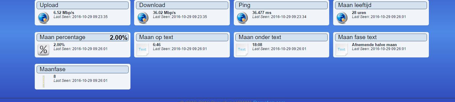

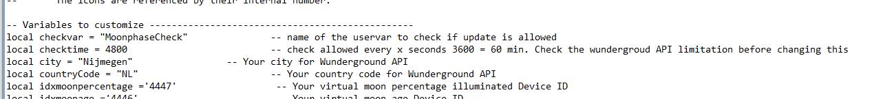

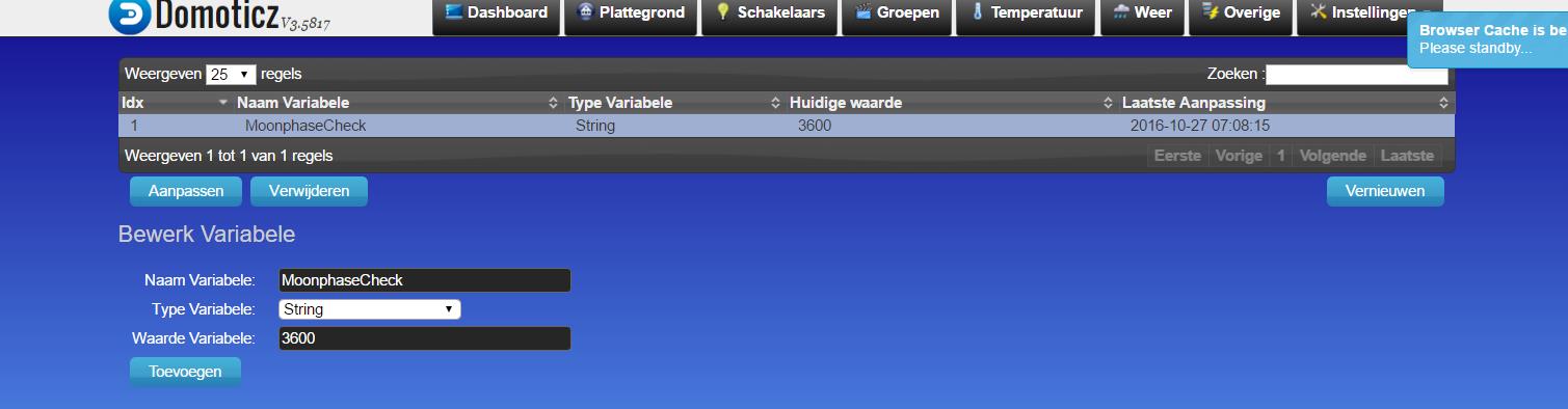

I do not understand the uservariable..
Is this correct?
Or what type do i need?
And this is ok?

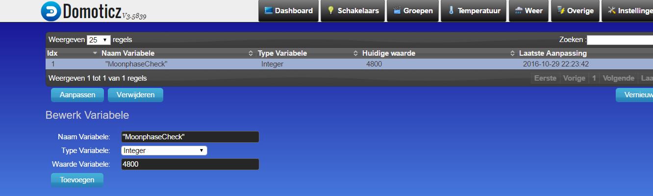

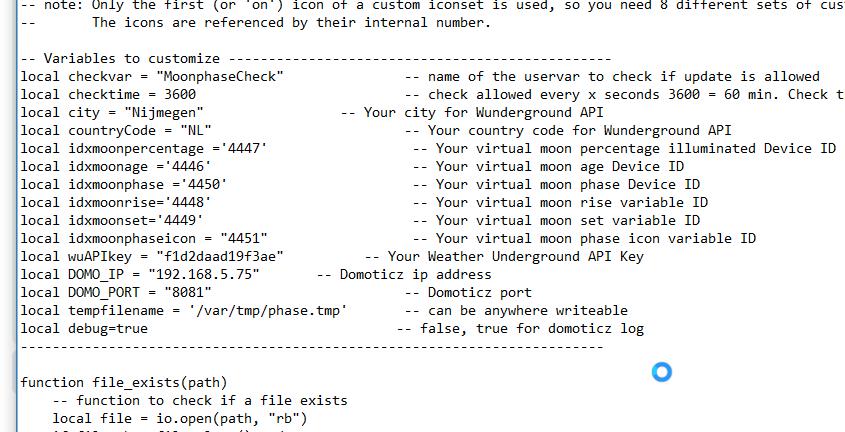

Derik wrote:@ wizjos,
Thanks for the support
Is this correct?
It looks OK to me (except that my uservar is of type Time).
The uservar is a helper in determining if an update from WU is allowed. WU only lets you poll 10 times in an hour. I found that the script was running too many times in an hour. So with some help from the wiki (http://www.domoticz.com/wiki/Smart_Lua_ ... _Light_Off) I made a check that, when WU has been polled, updates the uservar with the current time (again, this is purely cosmetic).
By updating the uservar the 'lastupdated' property of this uservar is set. This is a Domoticz internal property. (see line 74: commandArray['Variable:'..checkvar]=time.hour..":"..time.min). Each time the value of the uservar changes this property is set by Domoticz to the current date and time (See the column 'Laatste aanpassing' in your picture).
When the script runs again this 'lastupdated' property is checked (line 60: if (may_update(checkvar,checktime)==true) ).
The function may_update checks the difference between the current time and the time the uservar was last updated. If this difference is 3600 seconds the script allows an other update.
I see you've created a uservar of type Text and set the value to 3600. That's OK, but the value 3600 is not important...
Derik wrote:And this is ok?
As far as I can see it is. Be a bit more carefull with displaying your API key by the way!
I hope this helps!

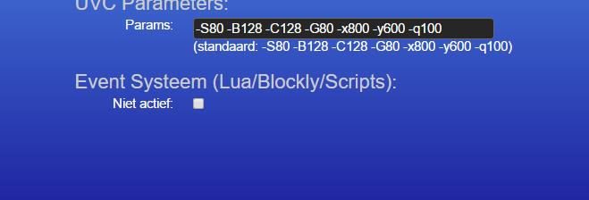

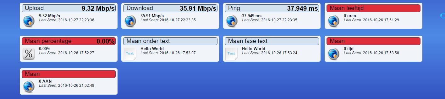

mmm Not working...
What can be the dombo error /mistake that i make?
Derik
Posts: 1605
Re: Moon phase
Post by Derik »
got him:
shame... did not not have activated the srcipt funtion:

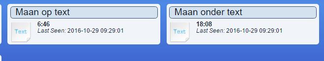

Only i think i changed the rise and set, is that correct??
And will you please tell me how you make the changing button with a moon icon...

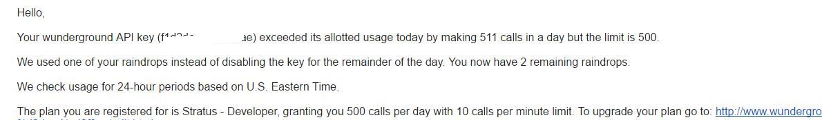

get a warning from wu..

Derik wrote:get a warning from wu..
That's why I tried to refer with my post above. IMHO the script is buggy in a way as it shouldn't run in every minute - that's 60 request from WU in an hour.

You have to set it up according to your needs. Just think - why would need to know a moon phase every minute? I have my script (above) running every 10 minutes or so. It generates only 6 requests per hour or 144 per day. I think running it one an hour would not hurt either.

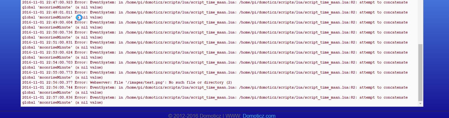

My error:
2016-10-31 19:03:00.797 Error: EventSystem: in /home/pi/domoticz/scripts/lua/script_time_maan.lua: /home/pi/domoticz/scripts/lua/script_time_maan.lua:148: attempt to concatenate global 'moonPhaseIcon' (a nil value)
2016-10-31 19:04:00.519 Error: Webserver: File '/images/test.png': No such file or directory (2)
2016-10-31 19:04:00.980 Error: EventSystem: in /home/pi/domoticz/scripts/lua/script_time_maan.lua: /home/pi/domoticz/scripts/lua/script_time_maan.lua:148: attempt to concatenate global 'moonPhaseIcon' (a nil value)
2016-10-31 19:05:00.545 Error: EventSystem: in /home/pi/domoticz/scripts/lua/script_time_maan.lua: /home/pi/domoticz/scripts/lua/script_time_maan.lua:148: attempt to concatenate global 'moonPhaseIcon' (a nil value)
2016-10-31 19:06:00.916 Error: EventSystem: in /home/pi/domoticz/scripts/lua/script_time_maan.lua: /home/pi/domoticz/scripts/lua/script_time_maan.lua:148: attempt to concatenate global 'moonPhaseIcon' (a nil value)
2016-10-31 19:07:01.019 Error: EventSystem: in /home/pi/domoticz/scripts/lua/script_time_maan.lua: /home/pi/domoticz/scripts/lua/script_time_maan.lua:148: attempt to concatenate global 'moonPhaseIcon' (a nil value)
2016-10-31 19:08:00.677 Error: EventSystem: in /home/pi/domoticz/scripts/lua/script_time_maan.lua: /home/pi/domoticz/scripts/lua/script_time_maan.lua:148: attempt to concatenate global 'moonPhaseIcon' (a nil value)

I just tried use this script, and i almost got it working but i also got the error:
EventSystem: in /home/pi/domoticz/scripts/lua/script_time_moon.lua: /home/pi/domoticz/scripts/lua/script_time_moon.lua:82: attempt to concatenate global 'moonriseMinute' (a nil value).
