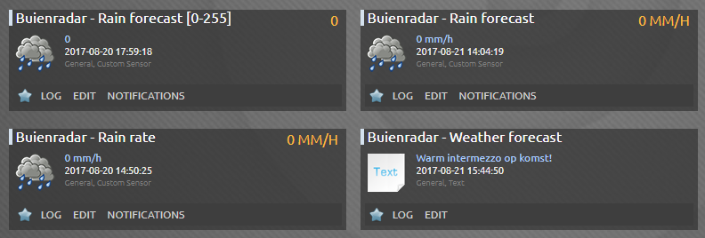

I have made some updates to the Buienradar script of @ffes.
Added the following devices (data from xml.buienradar.nl):
* Visibility
* Solar radiation
* Rain rate
* Weather forecast
* Rain forecast (uses data from https://gps.buienradar.nl/getrr.php?lat=51&lon=3)
Check this Dutch site for more information on the rain forecast.
I have made a pull request for this and hopefully it will be merged :D
